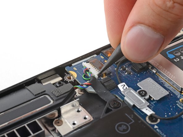

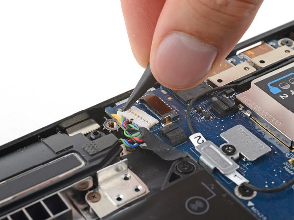

  10. Dell Latitude 7410 Speakers Replacement, Disconnect the speakers: crwdns2935265:010crwdnd2935265:01crwdnd2935265:03crwdne2935265:0 Dell Latitude 7410 Speakers Replacement, Disconnect the speakers: crwdns2935265:010crwdnd2935265:02crwdnd2935265:03crwdne2935265:0 Dell Latitude 7410 Speakers Replacement, Disconnect the speakers: crwdns2935265:010crwdnd2935265:03crwdnd2935265:03crwdne2935265:0
    • Use the point of a spudger to press on alternating side of the speaker connector to "walk" it out of its socket.

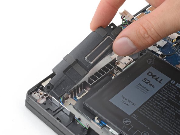

  11. Dell Latitude 7410 Speakers Replacement, Pry up the right speaker: crwdns2935265:011crwdnd2935265:01crwdnd2935265:03crwdne2935265:0 Dell Latitude 7410 Speakers Replacement, Pry up the right speaker: crwdns2935265:011crwdnd2935265:02crwdnd2935265:03crwdne2935265:0 Dell Latitude 7410 Speakers Replacement, Pry up the right speaker: crwdns2935265:011crwdnd2935265:03crwdnd2935265:03crwdne2935265:0
    • Insert the flat end of your spudger between the top edge of the right speaker and the frame.
    • Pry up to free the top rubber grommet on the speaker from the screw post.
  12. Dell Latitude 7410 Speakers Replacement, Remove the right speaker: crwdns2935265:012crwdnd2935265:01crwdnd2935265:02crwdne2935265:0 Dell Latitude 7410 Speakers Replacement, Remove the right speaker: crwdns2935265:012crwdnd2935265:02crwdnd2935265:02crwdne2935265:0
    • Be careful not to pull on the speaker cables, as they're routed along the front edge of the frame.
    • Grab the speaker and pry it up to free the bottom rubber grommet from the screw post.
