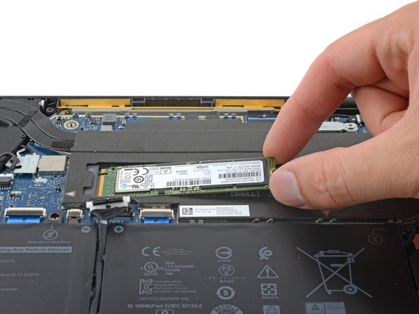

  11. Dell Latitude 7410 SSD Replacement, Unfasten the SSD: crwdns2935265:011crwdnd2935265:01crwdnd2935265:01crwdne2935265:0
    • Use your Phillips screwdriver to remove the 3 mm screw securing the SSD.
  12. Dell Latitude 7410 SSD Replacement, Remove the SSD: crwdns2935265:012crwdnd2935265:01crwdnd2935265:03crwdne2935265:0 Dell Latitude 7410 SSD Replacement, Remove the SSD: crwdns2935265:012crwdnd2935265:02crwdnd2935265:03crwdne2935265:0 Dell Latitude 7410 SSD Replacement, Remove the SSD: crwdns2935265:012crwdnd2935265:03crwdnd2935265:03crwdne2935265:0
    • The socket doesn't spring up the SSD like in some laptops—keep the SSD flat to the laptop when removing or inserting it to prevent damage to the socket.
    • Grip the corners of the SSD closest to the screw cutout and pull it straight out of its socket and remove it.
    • If the SSD feels stuck, slightly wiggle it side-to-side as you pull.
