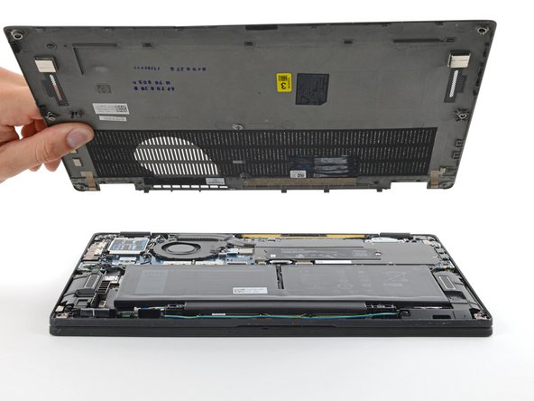

  2. Dell Latitude 7410 I/O Board Replacement, Unfasten the back cover: crwdns2935265:02crwdnd2935265:01crwdnd2935265:01crwdne2935265:0
    • Use a Phillips screwdriver to loosen the eight captive screws securing the back cover.
  3. Dell Latitude 7410 I/O Board Replacement, Insert an opening pick: crwdns2935265:03crwdnd2935265:01crwdnd2935265:02crwdne2935265:0 Dell Latitude 7410 I/O Board Replacement, Insert an opening pick: crwdns2935265:03crwdnd2935265:02crwdnd2935265:02crwdne2935265:0
    • Insert an opening pick between the right edge of the back cover and the frame, just below the middle right screw.
  4. Dell Latitude 7410 I/O Board Replacement, Unclip the right edge: crwdns2935265:04crwdnd2935265:01crwdnd2935265:02crwdne2935265:0 Dell Latitude 7410 I/O Board Replacement, Unclip the right edge: crwdns2935265:04crwdnd2935265:02crwdnd2935265:02crwdne2935265:0
    • Slide your pick along the right edge to release the clips securing the back cover.
  5. Dell Latitude 7410 I/O Board Replacement, Unclip the left edge: crwdns2935265:05crwdnd2935265:01crwdnd2935265:03crwdne2935265:0 Dell Latitude 7410 I/O Board Replacement, Unclip the left edge: crwdns2935265:05crwdnd2935265:02crwdnd2935265:03crwdne2935265:0 Dell Latitude 7410 I/O Board Replacement, Unclip the left edge: crwdns2935265:05crwdnd2935265:03crwdnd2935265:03crwdne2935265:0
    • Insert your pick between the left edge of the back cover and the frame, next to the speaker cutout.
    • Slide your pick along the left edge to release the clips.
  6. Dell Latitude 7410 I/O Board Replacement, Unclip the back edge: crwdns2935265:06crwdnd2935265:01crwdnd2935265:03crwdne2935265:0 Dell Latitude 7410 I/O Board Replacement, Unclip the back edge: crwdns2935265:06crwdnd2935265:02crwdnd2935265:03crwdne2935265:0 Dell Latitude 7410 I/O Board Replacement, Unclip the back edge: crwdns2935265:06crwdnd2935265:03crwdnd2935265:03crwdne2935265:0
    • Insert your pick between the back cover and the right display-hinge to release the first clip along the back edge.
    • Slide your pick toward the left hinge until the second clip releases.
  7. Dell Latitude 7410 I/O Board Replacement, Unclip the front edge: crwdns2935265:07crwdnd2935265:01crwdnd2935265:02crwdne2935265:0 Dell Latitude 7410 I/O Board Replacement, Unclip the front edge: crwdns2935265:07crwdnd2935265:02crwdnd2935265:02crwdne2935265:0
    • Insert your pick between the front edge of the back cover and the frame, just to the right of the bottom left screw.
    • Slide your pick toward the right edge until the front edge releases from the frame.
  8. Dell Latitude 7410 I/O Board Replacement, Remove the back cover: crwdns2935265:08crwdnd2935265:01crwdnd2935265:02crwdne2935265:0 Dell Latitude 7410 I/O Board Replacement, Remove the back cover: crwdns2935265:08crwdnd2935265:02crwdnd2935265:02crwdne2935265:0
    • Remove the back cover.

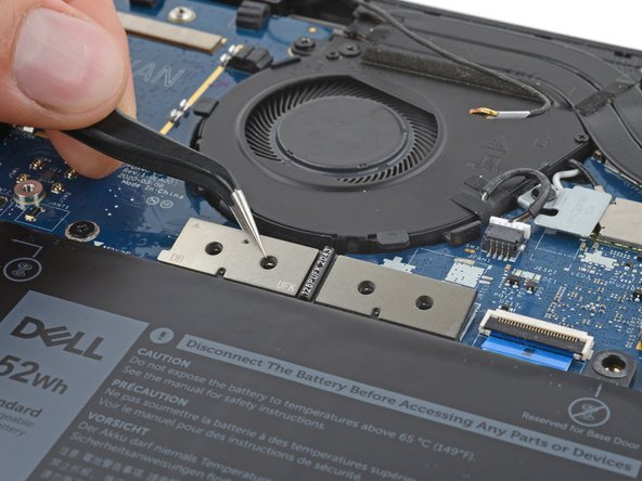

  9. Dell Latitude 7410 I/O Board Replacement, Disconnect the battery: crwdns2935265:09crwdnd2935265:01crwdnd2935265:02crwdne2935265:0 Dell Latitude 7410 I/O Board Replacement, Disconnect the battery: crwdns2935265:09crwdnd2935265:02crwdnd2935265:02crwdne2935265:0
    • Grab the black pull tab on the head of the battery connector and pull straight up to disconnect it.

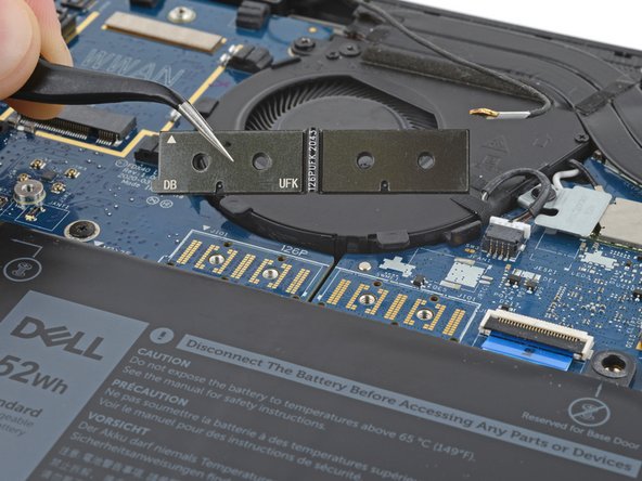

  10. Dell Latitude 7410 I/O Board Replacement, Remove the cover: crwdns2935265:010crwdnd2935265:01crwdnd2935265:03crwdne2935265:0 Dell Latitude 7410 I/O Board Replacement, Remove the cover: crwdns2935265:010crwdnd2935265:02crwdnd2935265:03crwdne2935265:0 Dell Latitude 7410 I/O Board Replacement, Remove the cover: crwdns2935265:010crwdnd2935265:03crwdnd2935265:03crwdne2935265:0
    • If your laptop doesn't come with a WWAN card, skip the next two steps.
    • Use the flat end of a spudger to pry up the WWAN card cover from its clips on the I/O board.
    • Remove the cover.

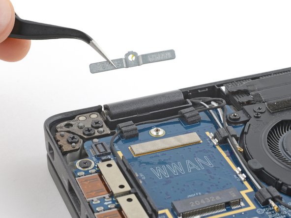

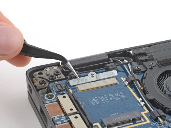

  11. Dell Latitude 7410 I/O Board Replacement, Remove the WWAN cable bracket: crwdns2935265:011crwdnd2935265:01crwdnd2935265:03crwdne2935265:0 Dell Latitude 7410 I/O Board Replacement, Remove the WWAN cable bracket: crwdns2935265:011crwdnd2935265:02crwdnd2935265:03crwdne2935265:0 Dell Latitude 7410 I/O Board Replacement, Remove the WWAN cable bracket: crwdns2935265:011crwdnd2935265:03crwdnd2935265:03crwdne2935265:0
    • Use your Phillips screwdriver to remove the 3 mm screw securing the WWAN cable bracket.
    • Remove the cable bracket.

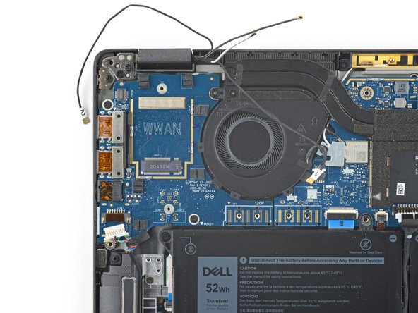

  13. Dell Latitude 7410 I/O Board Replacement, Disconnect the antenna cables: crwdns2935265:013crwdnd2935265:01crwdnd2935265:03crwdne2935265:0 Dell Latitude 7410 I/O Board Replacement, Disconnect the antenna cables: crwdns2935265:013crwdnd2935265:02crwdnd2935265:03crwdne2935265:0 Dell Latitude 7410 I/O Board Replacement, Disconnect the antenna cables: crwdns2935265:013crwdnd2935265:03crwdnd2935265:03crwdne2935265:0
    • Use your spudger to disconnect the antenna press connectors labeled 1 and 2 by prying the heads of their connectors straight up.
    • To re-attach press connectors, carefully align and press down on one side until it clicks into place, then repeat on the other side. Don't press down in the middle. If the connector is misaligned, the pins can bend and cause permanent damage.
  14. Dell Latitude 7410 I/O Board Replacement, Move the antenna cables: crwdns2935265:014crwdnd2935265:01crwdnd2935265:03crwdne2935265:0 Dell Latitude 7410 I/O Board Replacement, Move the antenna cables: crwdns2935265:014crwdnd2935265:02crwdnd2935265:03crwdne2935265:0 Dell Latitude 7410 I/O Board Replacement, Move the antenna cables: crwdns2935265:014crwdnd2935265:03crwdnd2935265:03crwdne2935265:0
    • This step shows a laptop that didn't come with a WWAN card. If yours has one, disconnect and remove it now.
    • Lift the antenna cables out from their cable routing on the I/O board and move them away from the board.

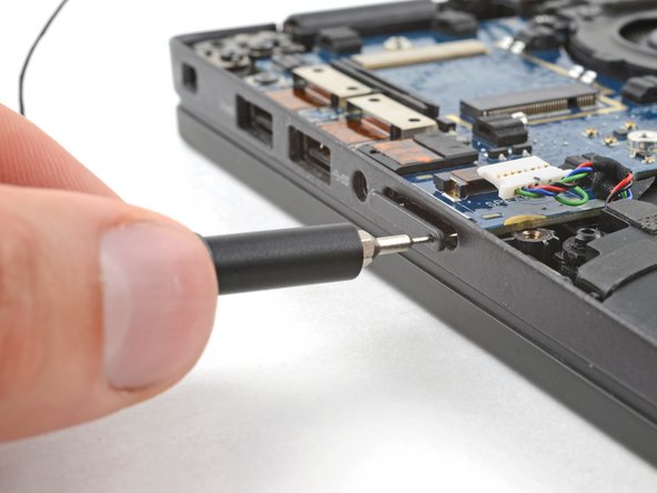

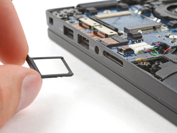

  15. Dell Latitude 7410 I/O Board Replacement, Remove the SIM card tray: crwdns2935265:015crwdnd2935265:01crwdnd2935265:03crwdne2935265:0 Dell Latitude 7410 I/O Board Replacement, Remove the SIM card tray: crwdns2935265:015crwdnd2935265:02crwdnd2935265:03crwdne2935265:0 Dell Latitude 7410 I/O Board Replacement, Remove the SIM card tray: crwdns2935265:015crwdnd2935265:03crwdnd2935265:03crwdne2935265:0
    • Insert a SIM card eject tool, bit, or straightened paperclip into the SIM eject hole.
    • Use your fingers to remove the SIM card tray.

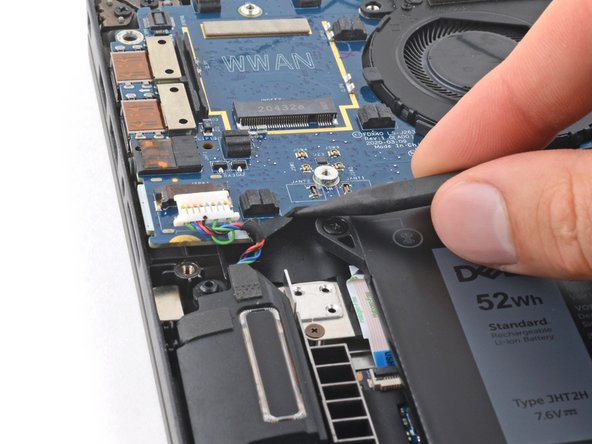

  17. Dell Latitude 7410 I/O Board Replacement, Unfasten the I/O board: crwdns2935265:017crwdnd2935265:01crwdnd2935265:02crwdne2935265:0 Dell Latitude 7410 I/O Board Replacement, Unfasten the I/O board: crwdns2935265:017crwdnd2935265:02crwdnd2935265:02crwdne2935265:0
    • Use your Phillips screwdriver to remove the three screws securing the I/O board:
    • Two 3 mm-long screws
    • One 3.5 mm-long screw

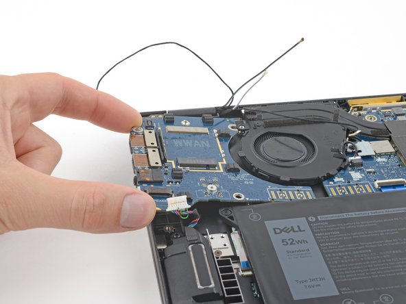

  18. Dell Latitude 7410 I/O Board Replacement, Pry up the I/O board: crwdns2935265:018crwdnd2935265:01crwdnd2935265:02crwdne2935265:0 Dell Latitude 7410 I/O Board Replacement, Pry up the I/O board: crwdns2935265:018crwdnd2935265:02crwdnd2935265:02crwdne2935265:0
    • Insert the flat end of your spudger between the bottom edge of the I/O board and the frame.
    • Gently pry up until you can grab the left edge of the board with your fingers.
    • If the board doesn't lift, double check that you've disconnected all cables and ejected the SIM card tray.

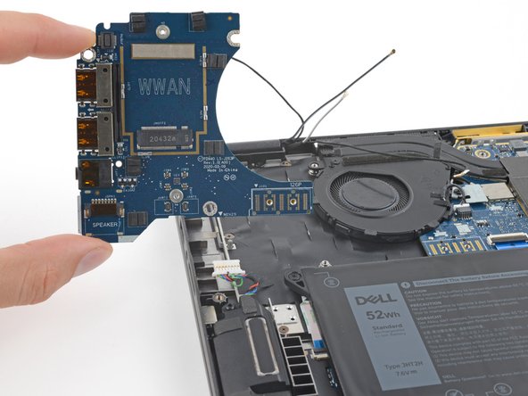

  19. Dell Latitude 7410 I/O Board Replacement, Remove the I/O board: crwdns2935265:019crwdnd2935265:01crwdnd2935265:03crwdne2935265:0 Dell Latitude 7410 I/O Board Replacement, Remove the I/O board: crwdns2935265:019crwdnd2935265:02crwdnd2935265:03crwdne2935265:0 Dell Latitude 7410 I/O Board Replacement, Remove the I/O board: crwdns2935265:019crwdnd2935265:03crwdnd2935265:03crwdne2935265:0
    • Grab the left edge of the I/O board.
    • Slide the board to the left until the top right screw mount clears the heatsink.
    • Remove the board.
