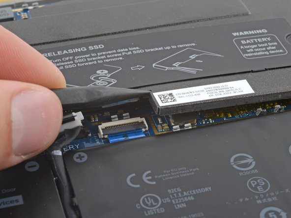

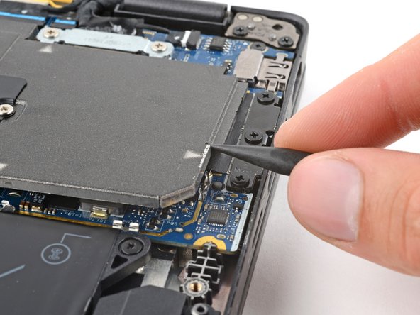

  14. Dell Latitude 7410 Heatsink Replacement, Unclip the heatsink shield: crwdns2935265:014crwdnd2935265:01crwdnd2935265:03crwdne2935265:0 Dell Latitude 7410 Heatsink Replacement, Unclip the heatsink shield: crwdns2935265:014crwdnd2935265:02crwdnd2935265:03crwdne2935265:0 Dell Latitude 7410 Heatsink Replacement, Unclip the heatsink shield: crwdns2935265:014crwdnd2935265:03crwdnd2935265:03crwdne2935265:0
    • Use the point of your spudger to pry up the heatsink shield from its clips on the motherboard at these spots:
    • The bottom left corner, just below the white arrow
    • The bottom middle, just to the left of the QR code
    • The bottom right, just above the white arrow
    • The white arrows indicate preferred prying locations. However, prying between the shield and the motherboard at these spots risks damaging small components.

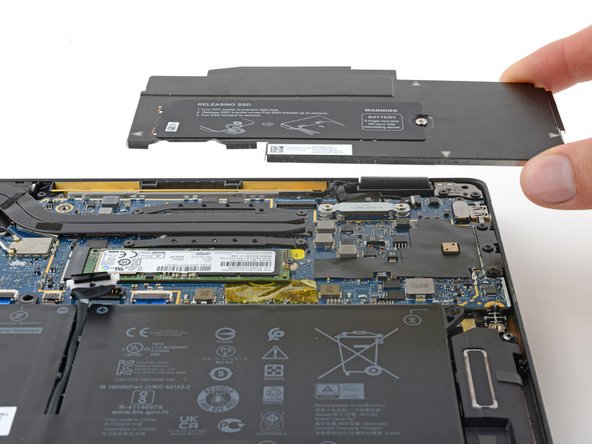

  15. Dell Latitude 7410 Heatsink Replacement, Remove the heatsink shield: crwdns2935265:015crwdnd2935265:01crwdnd2935265:02crwdne2935265:0 Dell Latitude 7410 Heatsink Replacement, Remove the heatsink shield: crwdns2935265:015crwdnd2935265:02crwdnd2935265:02crwdne2935265:0
    • Remove the heatsink shield.

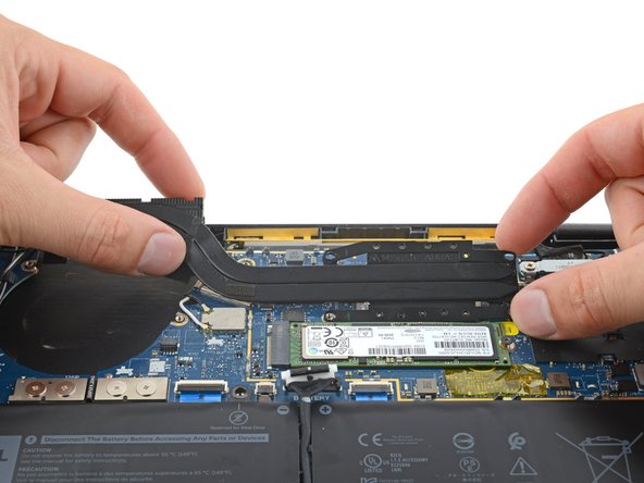

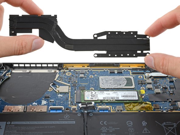

  17. Dell Latitude 7410 Heatsink Replacement, Remove the heatsink: crwdns2935265:017crwdnd2935265:01crwdnd2935265:03crwdne2935265:0 Dell Latitude 7410 Heatsink Replacement, Remove the heatsink: crwdns2935265:017crwdnd2935265:02crwdnd2935265:03crwdne2935265:0 Dell Latitude 7410 Heatsink Replacement, Remove the heatsink: crwdns2935265:017crwdnd2935265:03crwdnd2935265:03crwdne2935265:0
    • Pry the heatsink from the thermal paste bonding it to the CPU.
    • Depending on the age of your laptop, this might require some force. If it feels stuck, gently rotate it back and forth.
    • Remove the heatsink.
    • During reassembly, clean the old thermal paste from the CPU and the heatsink (if you're reusing it) and apply new thermal paste before installing your heatsink.
