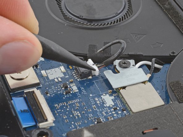

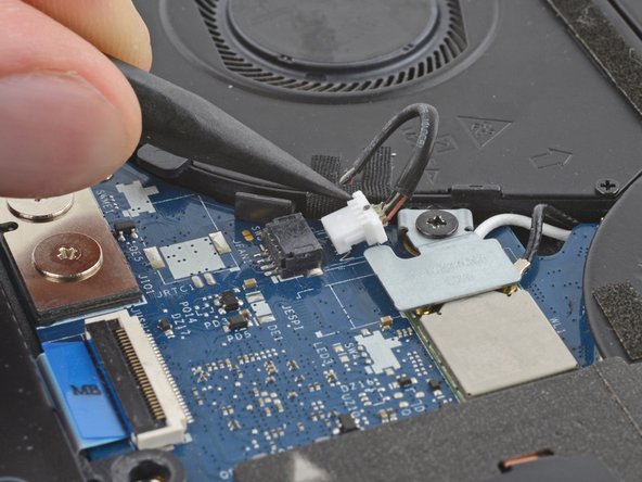

  10. Dell Latitude 7410 Fan Replacement, Disconnect the fan: crwdns2935265:010crwdnd2935265:01crwdnd2935265:03crwdne2935265:0 Dell Latitude 7410 Fan Replacement, Disconnect the fan: crwdns2935265:010crwdnd2935265:02crwdnd2935265:03crwdne2935265:0 Dell Latitude 7410 Fan Replacement, Disconnect the fan: crwdns2935265:010crwdnd2935265:03crwdnd2935265:03crwdne2935265:0
    • Use a spudger to press on alternating sides of the fan connector to "walk" it out of its socket.

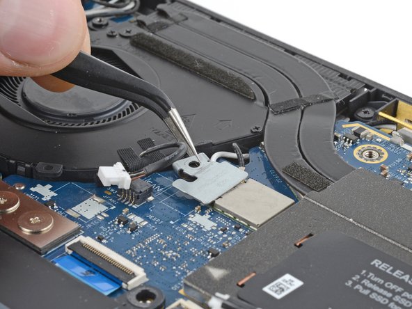

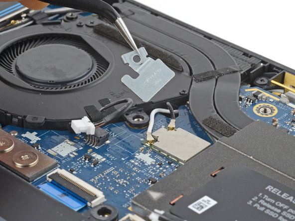

  11. Dell Latitude 7410 Fan Replacement, Remove the WLAN cable bracket: crwdns2935265:011crwdnd2935265:01crwdnd2935265:03crwdne2935265:0 Dell Latitude 7410 Fan Replacement, Remove the WLAN cable bracket: crwdns2935265:011crwdnd2935265:02crwdnd2935265:03crwdne2935265:0 Dell Latitude 7410 Fan Replacement, Remove the WLAN cable bracket: crwdns2935265:011crwdnd2935265:03crwdnd2935265:03crwdne2935265:0
    • Use your Phillips screwdriver to remove the 3 mm screw securing the WLAN connector cover.
    • Remove the cover.

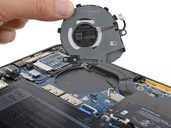

  12. Dell Latitude 7410 Fan Replacement, Unfasten the fan: crwdns2935265:012crwdnd2935265:01crwdnd2935265:01crwdne2935265:0
    • Use your Phillips screwdriver to remove the two 3 mm screws securing the fan.
  13. Dell Latitude 7410 Fan Replacement, Remove the fan: crwdns2935265:013crwdnd2935265:01crwdnd2935265:03crwdne2935265:0 Dell Latitude 7410 Fan Replacement, Remove the fan: crwdns2935265:013crwdnd2935265:02crwdnd2935265:03crwdne2935265:0 Dell Latitude 7410 Fan Replacement, Remove the fan: crwdns2935265:013crwdnd2935265:03crwdnd2935265:03crwdne2935265:0

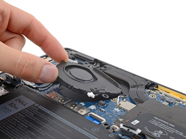

    • Slide the fan out from the heatsink and remove it.
