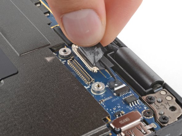

  16. Dell Latitude 7410 Display Assembly Replacement, Disconnect the display assembly: crwdns2935265:016crwdnd2935265:01crwdnd2935265:02crwdne2935265:0 Dell Latitude 7410 Display Assembly Replacement, Disconnect the display assembly: crwdns2935265:016crwdnd2935265:02crwdnd2935265:02crwdne2935265:0
    • Use tweezers or your fingers to disconnect the leftmost wide connector by pulling it straight out of its socket.
  17. Dell Latitude 7410 Display Assembly Replacement: crwdns2935265:017crwdnd2935265:01crwdnd2935265:02crwdne2935265:0 Dell Latitude 7410 Display Assembly Replacement: crwdns2935265:017crwdnd2935265:02crwdnd2935265:02crwdne2935265:0
    • Use tweezers or your fingers to disconnect the narrow connector, just to the right of the previous connector, by pulling it straight out of its socket.
  18. Dell Latitude 7410 Display Assembly Replacement: crwdns2935265:018crwdnd2935265:01crwdnd2935265:02crwdne2935265:0 Dell Latitude 7410 Display Assembly Replacement: crwdns2935265:018crwdnd2935265:02crwdnd2935265:02crwdne2935265:0
    • Use your fingers to grab the display connector pull tab and pull straight up to disconnect the display.
    • During reassembly, reconnect this cable before the two leftmost connectors.
  19. Dell Latitude 7410 Display Assembly Replacement: crwdns2935265:019crwdnd2935265:01crwdnd2935265:02crwdne2935265:0 Dell Latitude 7410 Display Assembly Replacement: crwdns2935265:019crwdnd2935265:02crwdnd2935265:02crwdne2935265:0
    • Use tweezers or your fingers to disconnect the camera connector by pulling it straight out of its socket.
