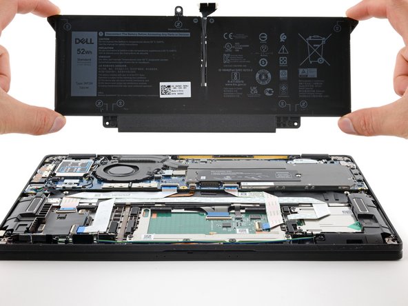

  10. Dell Latitude 7410 Battery Replacement, Unfasten the battery: crwdns2935265:010crwdnd2935265:01crwdnd2935265:01crwdne2935265:0
    • Use your Phillips screwdriver to loosen the four captive screws securing the battery.
  11. Dell Latitude 7410 Battery Replacement, Remove the battery: crwdns2935265:011crwdnd2935265:01crwdnd2935265:02crwdne2935265:0 Dell Latitude 7410 Battery Replacement, Remove the battery: crwdns2935265:011crwdnd2935265:02crwdnd2935265:02crwdne2935265:0
    • Remove the battery.
For optimal performance, calibrate your newly installed battery after completing this guide.
