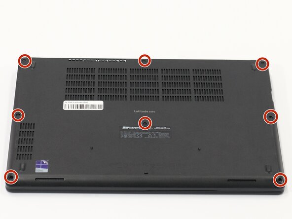

    • Orient your laptop to access the bottom cover, with the fan vents facing upwards.

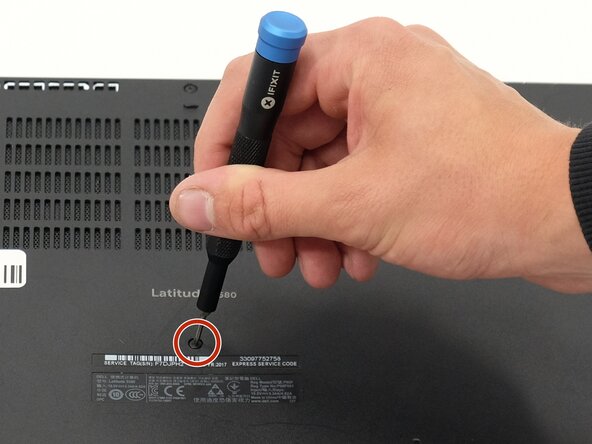

    • Use a Phillips #00 screwdriver to loosen the eight screws securing the bottom cover.
    • They are captive screws and do not fully come out of the holes. Don't force them or you may damage the screws or holes on the bottom case.

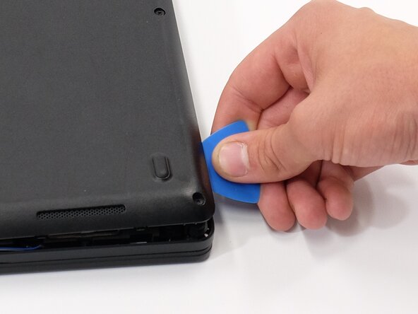

    • Insert the end of an iFixit opening tool or opening picks into the seam between the bottom and top case to release the clips holding them together.
    • Slide the opening tool or pick around the edge of the laptop until it is fully separated.
    • Remove the bottom cover.

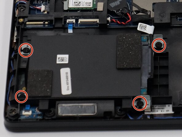

    • Use a Phillips #00 screwdriver to remove the four 5.8 mm screws securing the hard drive to the computer.

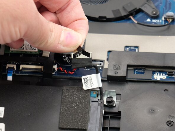

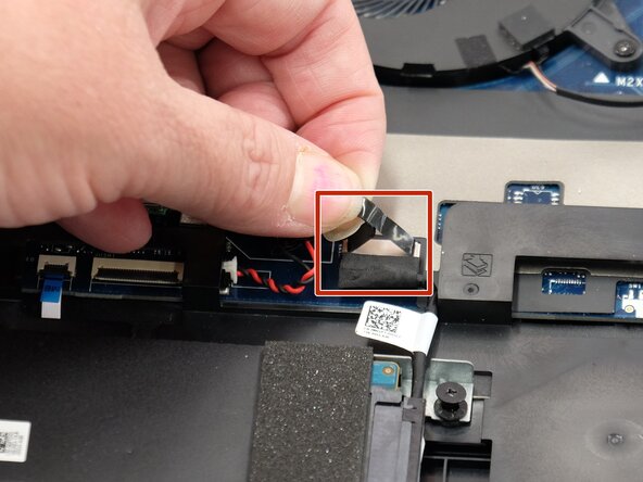

  3. Dell Latitude 5580 Hard Drive Replacement: crwdns2935265:03crwdnd2935265:01crwdnd2935265:03crwdne2935265:0 Dell Latitude 5580 Hard Drive Replacement: crwdns2935265:03crwdnd2935265:02crwdnd2935265:03crwdne2935265:0 Dell Latitude 5580 Hard Drive Replacement: crwdns2935265:03crwdnd2935265:03crwdnd2935265:03crwdne2935265:0

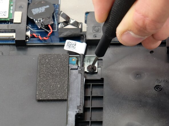

    • Carefully, pull straight up on the plastic strip of the hard drive connector, to disconnect the hard drive cable from the motherboard.

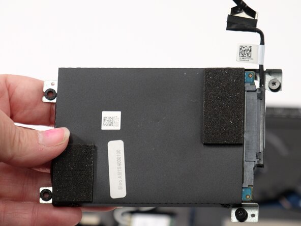

    • Remove the hard drive from your laptop.
    • Remove the hard drive from the adapter.
