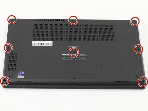

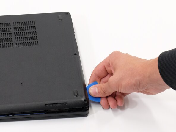

    • Orient your laptop so you can access the bottom cover, with the fan vents facing upwards.

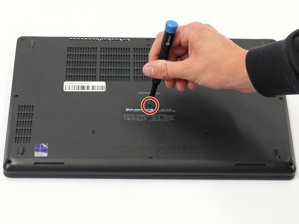

    • Use a Phillips #00 screwdriver to loosen the eight screws securing the bottom cover.
    • They are captive screws and do not fully come out of the holes. Don't force them or you may damage the screws or holes on the bottom case.
    • Insert the end of an iFixit opening tool or opening picks into the seam between the bottom and top case to release the clips holding them together.
    • Slide the opening tool or pick around the edge of the laptop until it is fully separated.
    • Remove the bottom cover.

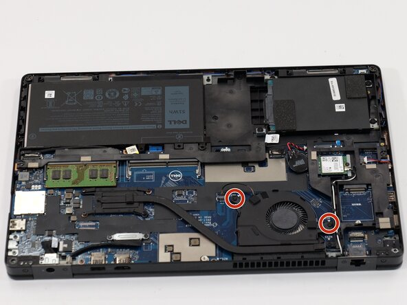

    • Use a Phillips #00 screwdriver to remove the two 3.1 mm screws holding the fan down.

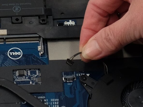

  3. Dell Latitude 5580 Fan Replacement: crwdns2935265:03crwdnd2935265:01crwdnd2935265:03crwdne2935265:0 Dell Latitude 5580 Fan Replacement: crwdns2935265:03crwdnd2935265:02crwdnd2935265:03crwdne2935265:0 Dell Latitude 5580 Fan Replacement: crwdns2935265:03crwdnd2935265:03crwdnd2935265:03crwdne2935265:0

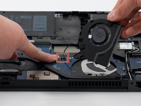

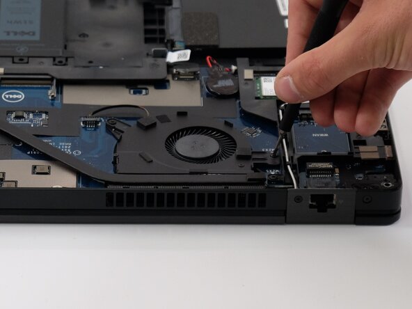

    • Use the point of a spudger to push on alternating sides of the connector to "walk" the JST connector out of its socket.
    • It may take a lot of alternating before the connector comes out. Be patient, and don't pull on the cables.
    • If that doesn't work, use a pair of tweezers to firmly grip the sides of the connector and pull straight away from the socket. Hold the tweezers closer to the connector to get a better grip.
    • If you're having trouble, try rocking the connector side-to-side to loosen it.

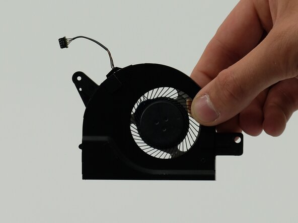

    • Remove the fan from your laptop.
