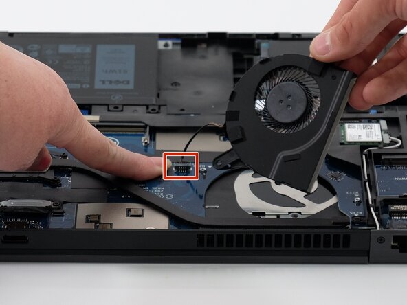

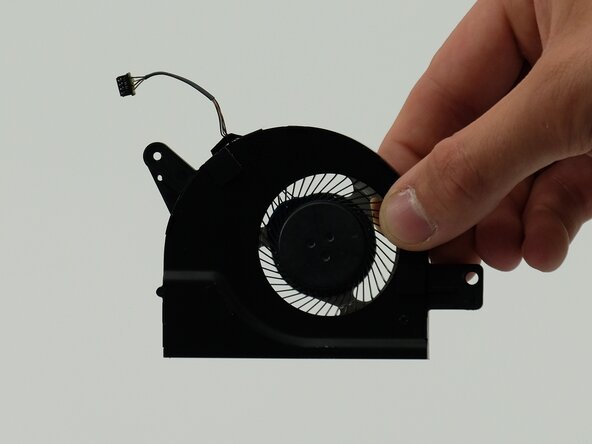

  5. Dell Latitude 5580 Display Replacement, Display: crwdns2935265:05crwdnd2935265:01crwdnd2935265:02crwdne2935265:0 Dell Latitude 5580 Display Replacement, Display: crwdns2935265:05crwdnd2935265:02crwdnd2935265:02crwdne2935265:0
    • Use a Phillips #00 screwdriver to remove the two 3.1 mm screws holding the fan down.
  6. Dell Latitude 5580 Display Replacement: crwdns2935265:06crwdnd2935265:01crwdnd2935265:03crwdne2935265:0 Dell Latitude 5580 Display Replacement: crwdns2935265:06crwdnd2935265:02crwdnd2935265:03crwdne2935265:0 Dell Latitude 5580 Display Replacement: crwdns2935265:06crwdnd2935265:03crwdnd2935265:03crwdne2935265:0
    • Use the point of a spudger to push on alternating sides of the connector to "walk" the JST connector out of its socket.
    • It may take a lot of alternating before the connector comes out. Be patient, and don't pull on the cables.
    • If that doesn't work, use a pair of tweezers to firmly grip the sides of the connector and pull straight away from the socket. Hold the tweezers closer to the connector to get a better grip.
    • If you're having trouble, try rocking the connector side-to-side to loosen it.
    • Remove the fan from your laptop.

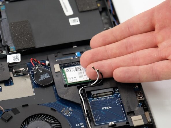

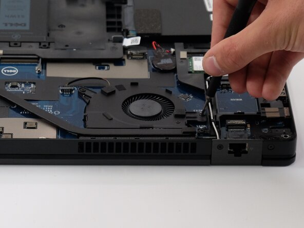

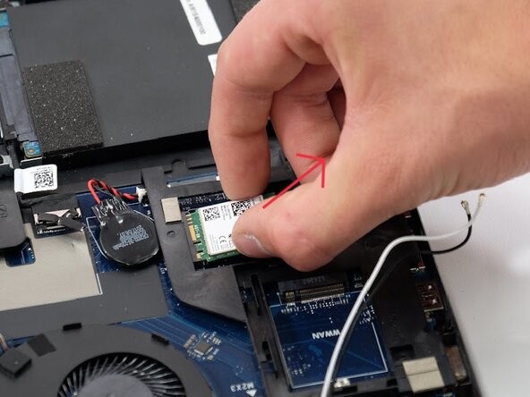

  7. Dell Latitude 5580 Display Replacement: crwdns2935265:07crwdnd2935265:01crwdnd2935265:03crwdne2935265:0 Dell Latitude 5580 Display Replacement: crwdns2935265:07crwdnd2935265:02crwdnd2935265:03crwdne2935265:0 Dell Latitude 5580 Display Replacement: crwdns2935265:07crwdnd2935265:03crwdnd2935265:03crwdne2935265:0
    • Use a Phillips #00 screwdriver to remove the single 3.1 mm screw holding down the green Wi-Fi card.
    • Slide a thin, ESD-safe pry tool or angled tweezers under the metal neck of the coaxial cable connectors on the Wi-Fi card (as close to the head as possible) and lift straight up from the board.
    • When working with these connectors, it's key to always lift the head straight up. If pried on at an odd angle, you risk breaking the socket off of the board underneath.
    • Use tweezers to hold the connector in place over its socket and gently press down with your finger or a spudger—the connector should "snap" into place. If you're having trouble, reposition the head and try again. Don't force the connector down or you may damage it.
    • Slide the Wi-Fi card out of the socket to remove it.

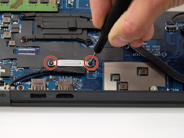

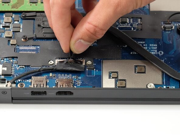

  8. Dell Latitude 5580 Display Replacement: crwdns2935265:08crwdnd2935265:01crwdnd2935265:03crwdne2935265:0 Dell Latitude 5580 Display Replacement: crwdns2935265:08crwdnd2935265:02crwdnd2935265:03crwdne2935265:0 Dell Latitude 5580 Display Replacement: crwdns2935265:08crwdnd2935265:03crwdnd2935265:03crwdne2935265:0
    • Remove the two 3.00 mm Phillips #00 screws securing the cover to the display cable port.
    • Pull the black tab on the display cable connector to safely separate from the motherboard.

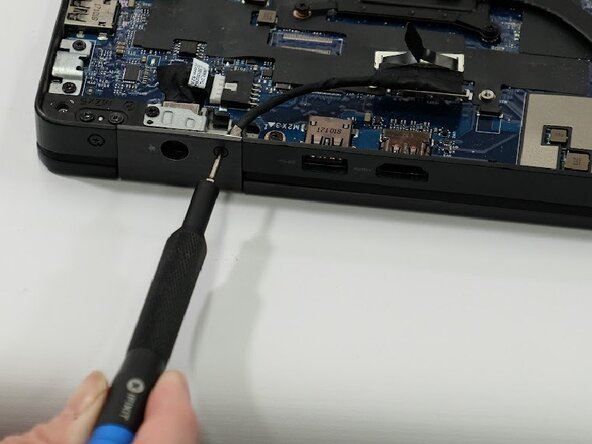

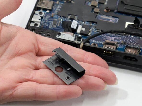

  9. Dell Latitude 5580 Display Replacement: crwdns2935265:09crwdnd2935265:01crwdnd2935265:03crwdne2935265:0 Dell Latitude 5580 Display Replacement: crwdns2935265:09crwdnd2935265:02crwdnd2935265:03crwdne2935265:0 Dell Latitude 5580 Display Replacement: crwdns2935265:09crwdnd2935265:03crwdnd2935265:03crwdne2935265:0
    • Remove the two 3.00 mm Phillips #00 screws securing the hinge covers.
    • Slide the hinge covers down and off the laptop. Since they have a slight “lip” wrapping around the hinge, you may have to prop the laptop up slightly.

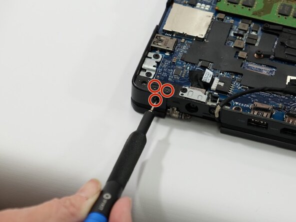

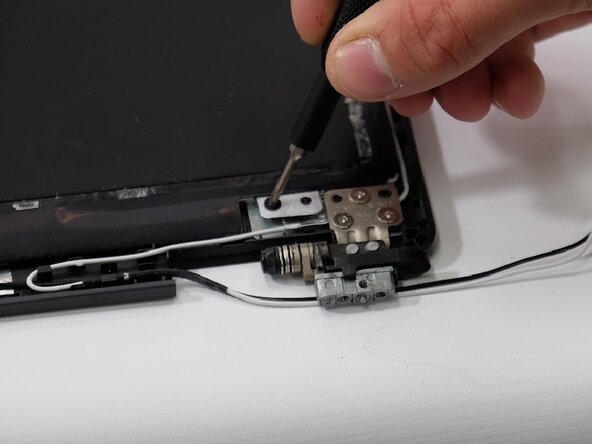

  10. Dell Latitude 5580 Display Replacement: crwdns2935265:010crwdnd2935265:01crwdnd2935265:02crwdne2935265:0 Dell Latitude 5580 Display Replacement: crwdns2935265:010crwdnd2935265:02crwdnd2935265:02crwdne2935265:0
    • Remove a total of six 6.1 mm Phillips #00 screws from both hinges.

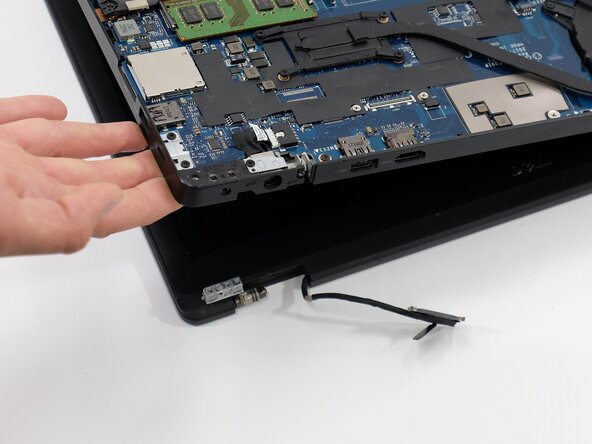

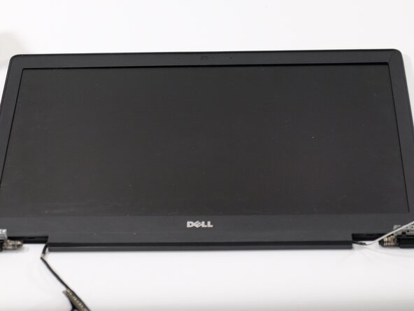

  11. Dell Latitude 5580 Display Replacement: crwdns2935265:011crwdnd2935265:01crwdnd2935265:03crwdne2935265:0 Dell Latitude 5580 Display Replacement: crwdns2935265:011crwdnd2935265:02crwdnd2935265:03crwdne2935265:0 Dell Latitude 5580 Display Replacement: crwdns2935265:011crwdnd2935265:03crwdnd2935265:03crwdne2935265:0
    • Move the Wi-Fi card wiring and display cable away from the hinge.
    • Lift the display and separate it from the rest of the laptop.

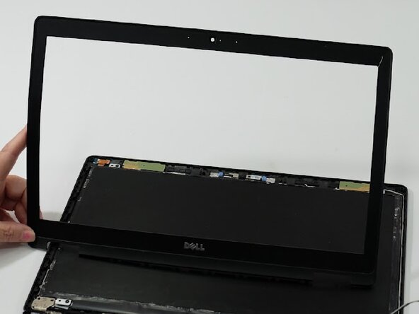

  12. Dell Latitude 5580 Display Replacement: crwdns2935265:012crwdnd2935265:01crwdnd2935265:02crwdne2935265:0 Dell Latitude 5580 Display Replacement: crwdns2935265:012crwdnd2935265:02crwdnd2935265:02crwdne2935265:0
    • Insert the end of a spudger in between the bezel and the screen and work around the edges of the bezel, separating it from the screen.
    • Remove the bezel completely.
    • Be careful when removing the bezel as it can easily crack or break. You will need it when you replace the screen.

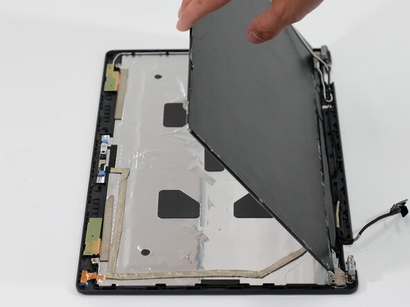

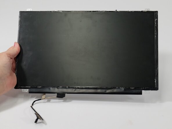

  13. Dell Latitude 5580 Display Replacement: crwdns2935265:013crwdnd2935265:01crwdnd2935265:03crwdne2935265:0 Dell Latitude 5580 Display Replacement: crwdns2935265:013crwdnd2935265:02crwdnd2935265:03crwdne2935265:0 Dell Latitude 5580 Display Replacement: crwdns2935265:013crwdnd2935265:03crwdnd2935265:03crwdne2935265:0
    • Use a Phillips #00 screwdriver to remove the four 3.0 mm screws securing the screen.
    • Carefully rotate the screen over, pivoting at the bottom where the cable connects.

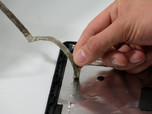

  14. Dell Latitude 5580 Display Replacement: crwdns2935265:014crwdnd2935265:01crwdnd2935265:03crwdne2935265:0 Dell Latitude 5580 Display Replacement: crwdns2935265:014crwdnd2935265:02crwdnd2935265:03crwdne2935265:0 Dell Latitude 5580 Display Replacement: crwdns2935265:014crwdnd2935265:03crwdnd2935265:03crwdne2935265:0
    • Carefully disconnect the display ribbon connector.
    • Separate the adhered ribbon cable from the panel.
    • Remove the screen.
