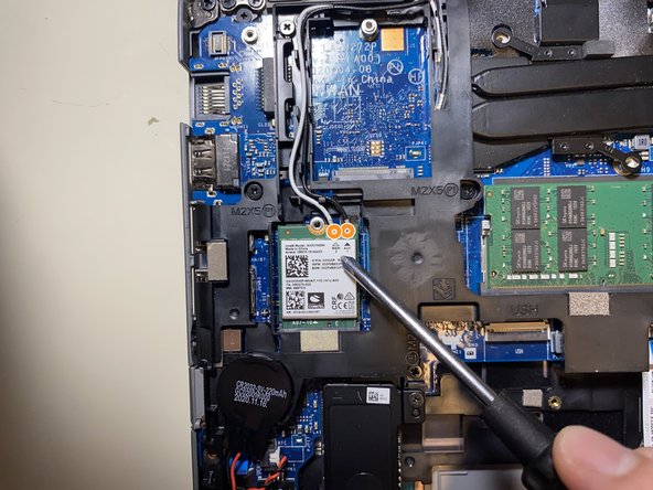

    • Remove the one 1 mm Phillips #1 screw that secures the Wi-Fi card.
    • Take note of which color wire went into each spot, then disconnect the antenna cable connectors by lifting them straight up.

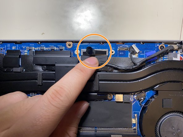

    • Remove the two 2 mm Phillips #1 screws that secure the display cable bracket.
    • Pull straight up on the display connector pull tab to disconnect the cable.
    • Disconnect the touchpad connector by pulling it straight out of its socket.

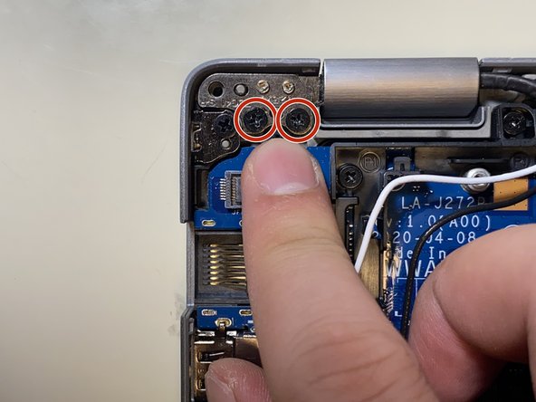

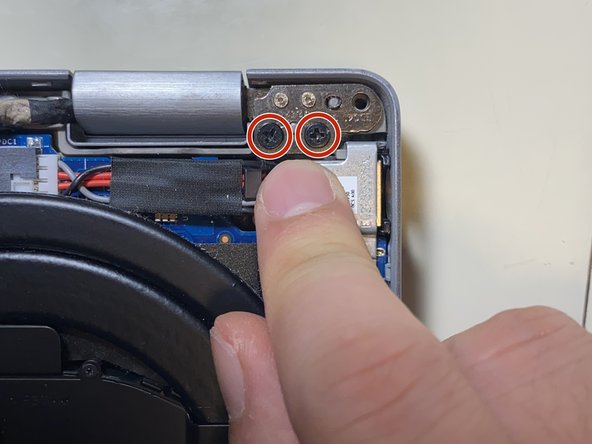

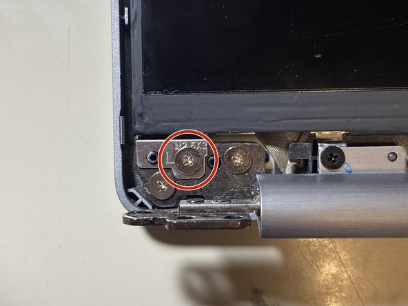

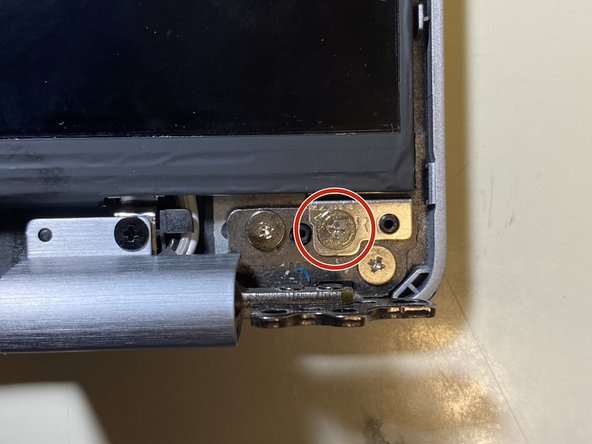

    • Remove the four 2.5x5 Phillips #1 screws securing the hinges to the chassis.

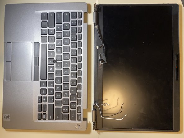

    • Open up the laptop to 90 degrees.
    • Pull the laptop chassis from the laptop screen and separate them.

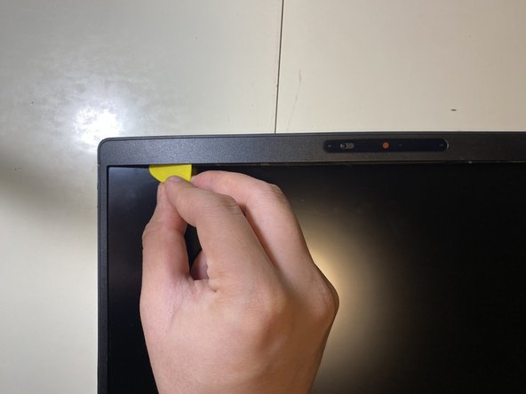

    • Insert an opening pick into seam between the bezel and the back display cover. Slide and pry around the entire perimeter to separate the entire bezel from the back cover.

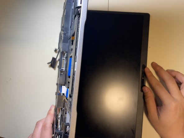

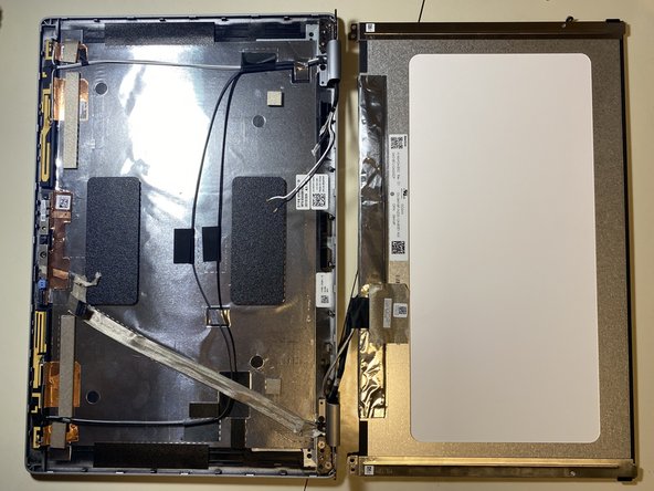

    • Lift the display up and out.
  11. Dell Latitude 5411 Webcam Replacement: crwdns2935265:011crwdnd2935265:01crwdnd2935265:02crwdne2935265:0 Dell Latitude 5411 Webcam Replacement: crwdns2935265:011crwdnd2935265:02crwdnd2935265:02crwdne2935265:0

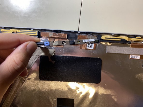

    • Disconnect the camera cable.
    • Lift the laptop webcam up and out.
