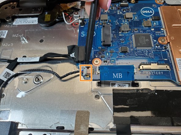

    • Remove the motherboard cable by pulling up on the black bar and carefully removing the blue ribbon cable.
    • Disconnect the white speaker cable connector.

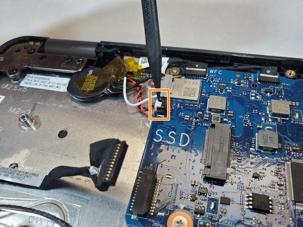

    • Using a spudger, disconnect the black power board and audio cable.
    • Disconnect the white coin cell battery cable.

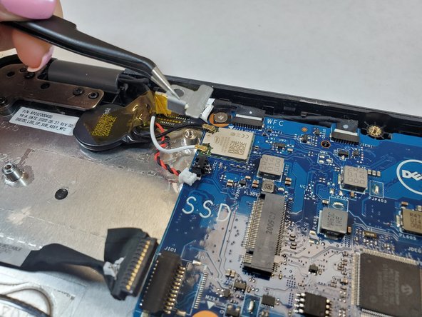

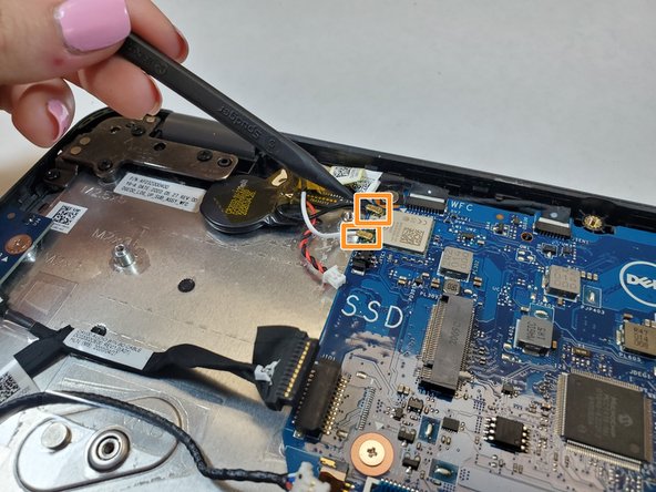

    • Use the Phillips #0 screwdriver to remove the 3 mm screw and lift the metal bracket that secures the WLAN card on the system board.
    • Disconnect the black and white WLAN cables.

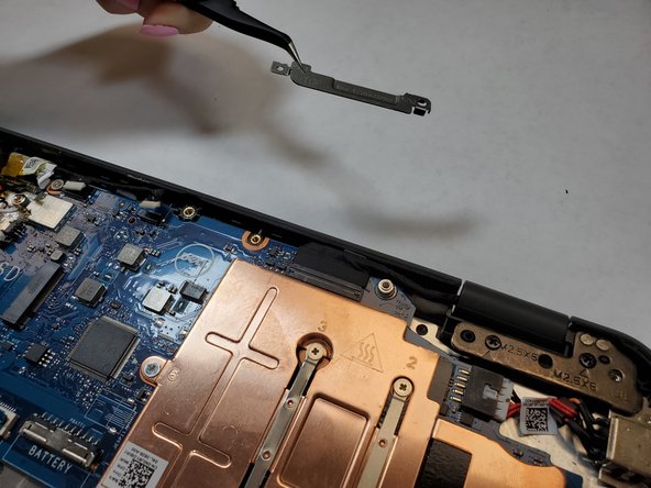

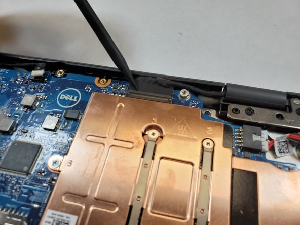

    • Use the Phillips #0 screwdriver to remove the two 3 mm screws from the metal bracket on the display cable.
    • Lift the metal bracket that secures the display cable on the computer.
    • Disconnect the black display cable using a spudger or pull it out by hand.

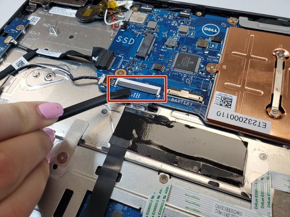

    • Use the spudger to lift up on black bar to release the trackpad ribbon cable.
    • Pull the blue tab release to the cable from the connector.
  15. Dell Latitude 3190 Motherboard Replacement: crwdns2935265:015crwdnd2935265:01crwdnd2935265:03crwdne2935265:0 Dell Latitude 3190 Motherboard Replacement: crwdns2935265:015crwdnd2935265:02crwdnd2935265:03crwdne2935265:0 Dell Latitude 3190 Motherboard Replacement: crwdns2935265:015crwdnd2935265:03crwdnd2935265:03crwdne2935265:0
    • Use a Phillips #0 tp remove the two 3 mm screws on the metal bracket that secures the board.
    • Remove the metal bracket.

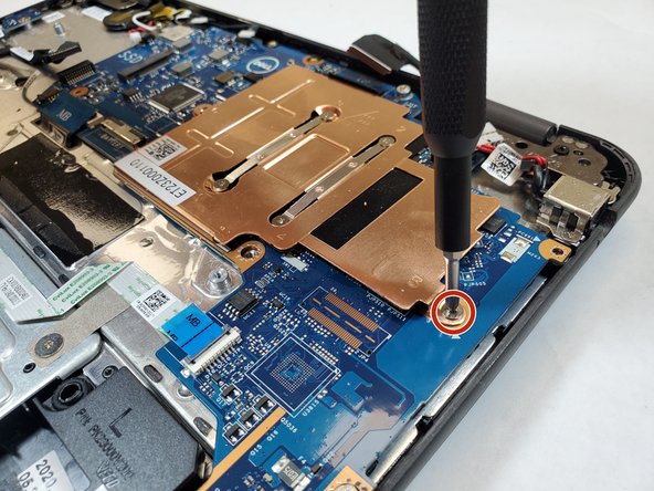

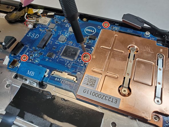

  16. Dell Latitude 3190 Motherboard Replacement: crwdns2935265:016crwdnd2935265:01crwdnd2935265:03crwdne2935265:0 Dell Latitude 3190 Motherboard Replacement: crwdns2935265:016crwdnd2935265:02crwdnd2935265:03crwdne2935265:0 Dell Latitude 3190 Motherboard Replacement: crwdns2935265:016crwdnd2935265:03crwdnd2935265:03crwdne2935265:0
    • Use the Phillips #0 screwdriver to remove the five 3 mm screws that secure the motherboard.
  17. Dell Latitude 3190 Motherboard Replacement: crwdns2935265:017crwdnd2935265:01crwdnd2935265:03crwdne2935265:0 Dell Latitude 3190 Motherboard Replacement: crwdns2935265:017crwdnd2935265:02crwdnd2935265:03crwdne2935265:0 Dell Latitude 3190 Motherboard Replacement: crwdns2935265:017crwdnd2935265:03crwdnd2935265:03crwdne2935265:0
    • Carefully lift the motherboard up to remove it from the computer.
    • Make sure not to snag any of the other cables.
