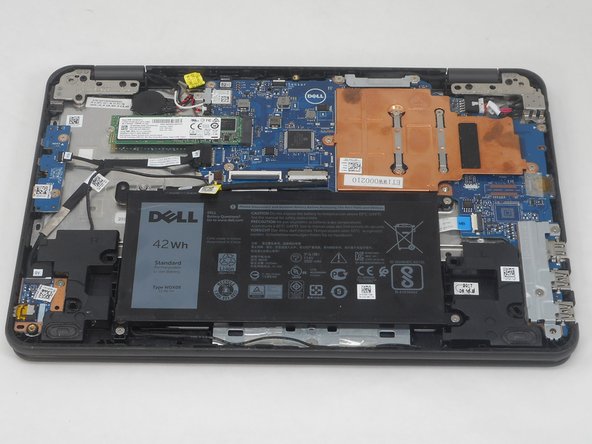

  3. Dell Latitude 3189 Battery Replacement: crwdns2935265:03crwdnd2935265:01crwdnd2935265:02crwdne2935265:0 Dell Latitude 3189 Battery Replacement: crwdns2935265:03crwdnd2935265:02crwdnd2935265:02crwdne2935265:0
    • Grip and lift the lower case up and away.
    • If you feel any significant resistance, double check that all of the screws are loosened.

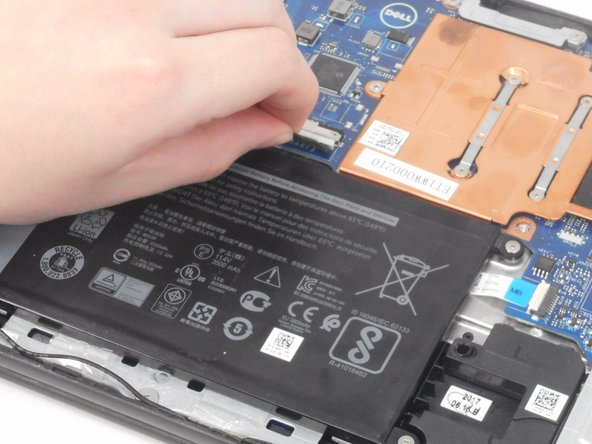

  4. Dell Latitude 3189 Battery Replacement: crwdns2935265:04crwdnd2935265:01crwdnd2935265:03crwdne2935265:0 Dell Latitude 3189 Battery Replacement: crwdns2935265:04crwdnd2935265:02crwdnd2935265:03crwdne2935265:0 Dell Latitude 3189 Battery Replacement: crwdns2935265:04crwdnd2935265:03crwdnd2935265:03crwdne2935265:0
    • Before performing any operations within the laptop, unplug the battery.
    • Pull the white battery connector directly out of its motherboard port.
    • Do not pull on the wires.

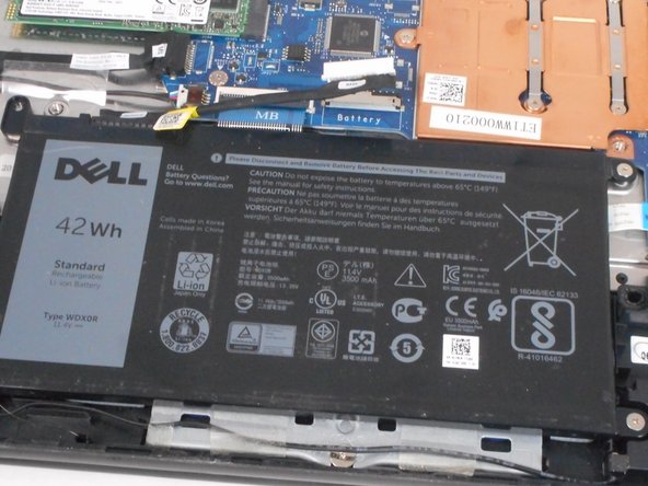

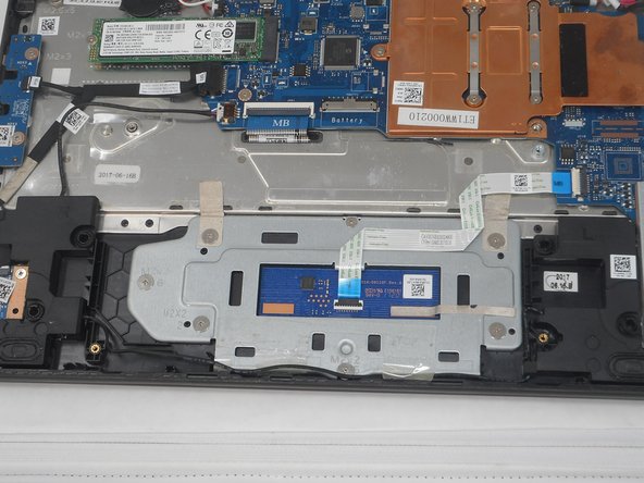

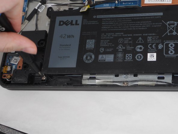

  5. Dell Latitude 3189 Battery Replacement, Battery: crwdns2935265:05crwdnd2935265:01crwdnd2935265:02crwdne2935265:0 Dell Latitude 3189 Battery Replacement, Battery: crwdns2935265:05crwdnd2935265:02crwdnd2935265:02crwdne2935265:0
    • Use a Phillips #0 screwdriver to remove the three 3.2 mm screws that secure the battery.
  6. Dell Latitude 3189 Battery Replacement: crwdns2935265:06crwdnd2935265:01crwdnd2935265:02crwdne2935265:0 Dell Latitude 3189 Battery Replacement: crwdns2935265:06crwdnd2935265:02crwdnd2935265:02crwdne2935265:0
    • Grip the battery and lift it up and out of the chassis.
