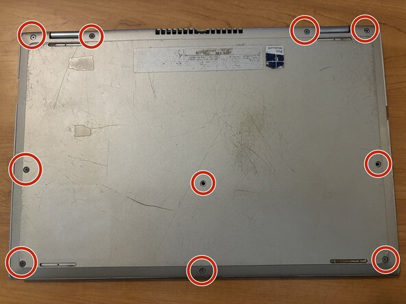

    • These are the screws located on the back cover of your laptop. They are JIS M2.5 x 7mm screws, which is the only type of screw you'll be dealing with in this guide. A Philips #0 iFixit screwdriver should fit these perfectly.
    • Unscrew all previously indicated screws like in the picture shown.
    • Keep the unscrewed screws somewhere secure so that you don't lose them. An inadequate number of screws can mean your laptop is unsecured at the base and may lead to damage.

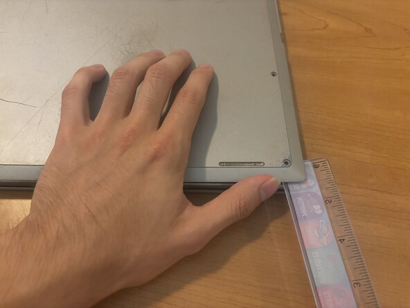

    • Use your plastic prying tool and insert it into the gap between the back cover and the base of the laptop. This guide will use a plastic ruler for demonstration.
    • Pry open (gently) the back cover by pushing the tool upwards and if all screws are removed, the cover should pop off easily.
    • Do not use a metal tool as this can lead to electrostatic discharge damage.
