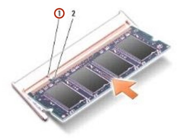

    4. Dell Inspiron 1210 Memory Module Replacement, Align the Notch: crwdns2935265:04crwdnd2935265:01crwdnd2935265:02crwdne2935265:0 Dell Inspiron 1210 Memory Module Replacement, Align the Notch: crwdns2935265:04crwdnd2935265:02crwdnd2935265:02crwdne2935265:0
      • Align the notch in the module edge connector with the tab in the connector slot.
    5. Dell Inspiron 1210 Memory Module Replacement, Sliding the Module: crwdns2935265:05crwdnd2935265:01crwdnd2935265:01crwdne2935265:0
      • Slide the NEW module firmly into the slot at a 45-degree angle, and rotate the module down until it clicks into place. If the module does not click into place, remove the module and reinstall it.
      • NOTE: If the memory module is not installed properly, the computer may not boot.
