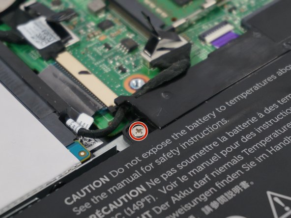

    • Pull back the sticker covering the first screw on the hard drive chaises.
    • Useing a Philips Head #0 screwdriver remove the three screws holding the drive in place.

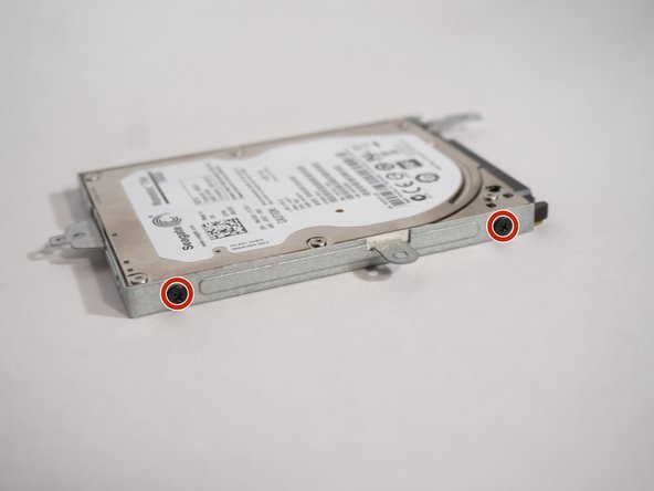

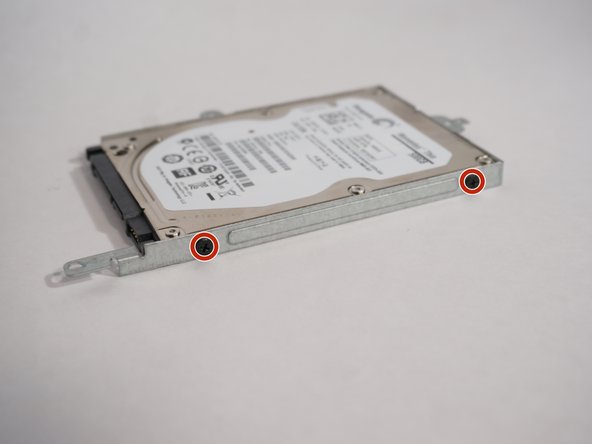

  6. Dell Inspiron 11-3147 Hard Drive Replacement: crwdns2935265:06crwdnd2935265:01crwdnd2935265:03crwdne2935265:0 Dell Inspiron 11-3147 Hard Drive Replacement: crwdns2935265:06crwdnd2935265:02crwdnd2935265:03crwdne2935265:0 Dell Inspiron 11-3147 Hard Drive Replacement: crwdns2935265:06crwdnd2935265:03crwdnd2935265:03crwdne2935265:0
    • Using a Philips Head #1 Screwdriver remove the four screws holding the hard drive to the chassis.
    • Remove the drive from the chassis. Care that the drive does not fall out once all the screwshave been removed.
