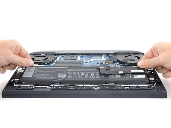

  5. Dell G15-5510 Gaming Battery Replacement, Disconnect the battery: crwdns2935265:05crwdnd2935265:01crwdnd2935265:03crwdne2935265:0 Dell G15-5510 Gaming Battery Replacement, Disconnect the battery: crwdns2935265:05crwdnd2935265:02crwdnd2935265:03crwdne2935265:0 Dell G15-5510 Gaming Battery Replacement, Disconnect the battery: crwdns2935265:05crwdnd2935265:03crwdnd2935265:03crwdne2935265:0
    • Use the flat end of a spudger to push the battery connector's square tab away from the socket and disconnect it.
  6. Dell G15-5510 Gaming Battery Replacement, Unfasten the battery: crwdns2935265:06crwdnd2935265:01crwdnd2935265:02crwdne2935265:0 Dell G15-5510 Gaming Battery Replacement, Unfasten the battery: crwdns2935265:06crwdnd2935265:02crwdnd2935265:02crwdne2935265:0
    • Use a Phillips screwdriver to remove the four 4.1 mm-long screws securing the battery.
  7. Dell G15-5510 Gaming Battery Replacement, Remove the battery: crwdns2935265:07crwdnd2935265:01crwdnd2935265:03crwdne2935265:0 Dell G15-5510 Gaming Battery Replacement, Remove the battery: crwdns2935265:07crwdnd2935265:02crwdnd2935265:03crwdne2935265:0 Dell G15-5510 Gaming Battery Replacement, Remove the battery: crwdns2935265:07crwdnd2935265:03crwdnd2935265:03crwdne2935265:0
    • Pull the battery towards the top of the laptop to separate it from its plastic shell.
    • Remove the battery.

needs extra slide about removing battery ribbon cable from the battery itself and attaching it to the replacement. After some research I found you're supposed to pry it upwards and NOT pull it outwards
