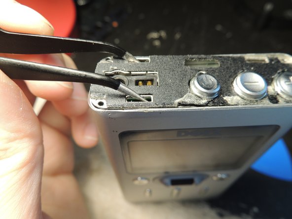

  4. Dell DJ 2nd Generation Disassembly, Remove screws and metal plates: crwdns2935265:04crwdnd2935265:01crwdnd2935265:02crwdne2935265:0 Dell DJ 2nd Generation Disassembly, Remove screws and metal plates: crwdns2935265:04crwdnd2935265:02crwdnd2935265:02crwdne2935265:0
    • There are eight Philips #00 screws, one on each corner at both ends of the device.
    • I don't recommend using tweezers to remove the plates like I did. You might bend the tips.

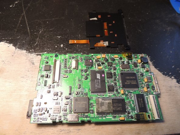

  8. Dell DJ 2nd Generation Disassembly, Remove the display (part 1): crwdns2935265:08crwdnd2935265:01crwdnd2935265:01crwdne2935265:0
    • Lift up the tabs on both sides.
    • Lift the left side of the display completely.
    • Don't force the tabs on the right; just unlatch them and push them up slightly so they don't snap back into place.
  9. Dell DJ 2nd Generation Disassembly, Remove the display (part 2): crwdns2935265:09crwdnd2935265:01crwdnd2935265:01crwdne2935265:0
    • Use your soldering iron to melt the solder holding the metal frame to the board. Use a small tool to gently pry the display up.
  10. Dell DJ 2nd Generation Disassembly, Remove the display (part 3): crwdns2935265:010crwdnd2935265:01crwdnd2935265:01crwdne2935265:0
    • Push the ends of the brown latch towards the screen, then remove the display.

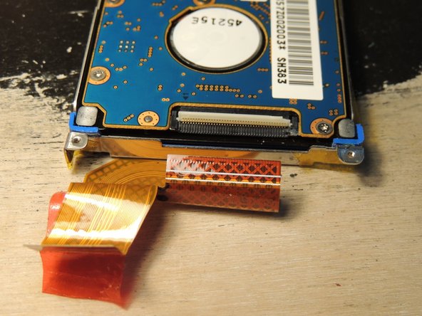

  12. Dell DJ 2nd Generation Disassembly, Disconnect the hard drive: crwdns2935265:012crwdnd2935265:01crwdnd2935265:02crwdne2935265:0 Dell DJ 2nd Generation Disassembly, Disconnect the hard drive: crwdns2935265:012crwdnd2935265:02crwdnd2935265:02crwdne2935265:0
    • Peel back the red tape. Then, lift up the latch and pull the cable out.

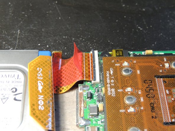

  13. Dell DJ 2nd Generation Disassembly, Disconnect the hard drive (again): crwdns2935265:013crwdnd2935265:01crwdnd2935265:02crwdne2935265:0 Dell DJ 2nd Generation Disassembly, Disconnect the hard drive (again): crwdns2935265:013crwdnd2935265:02crwdnd2935265:02crwdne2935265:0
    • This connector is the same as the one on the mainboard. The latch is beige on this one.
