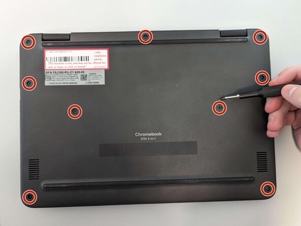

  2. Dell Chromebook 3110 Battery Replacement: crwdns2935265:02crwdnd2935265:01crwdnd2935265:01crwdne2935265:0
    • Remove nine 4 mm screws from the back cover of the laptop using a Phillips #00 screwdriver.

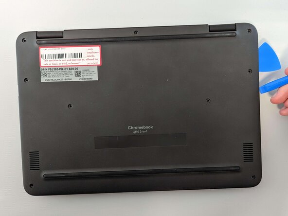

  3. Dell Chromebook 3110 Battery Replacement: crwdns2935265:03crwdnd2935265:01crwdnd2935265:01crwdne2935265:0
    • Using an opening pick and a plastic opening tool, begin to separate the back cover from the laptop.
    • Using your hands, fully remove the back cover.

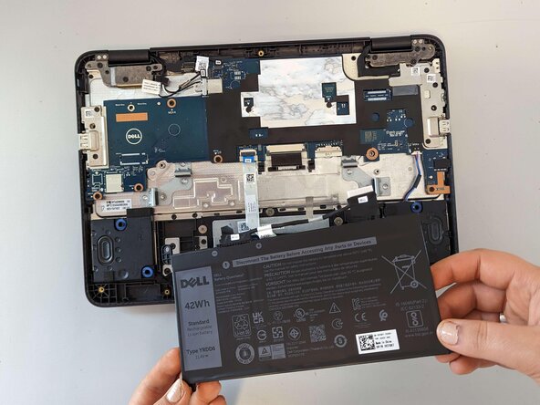

  4. Dell Chromebook 3110 Battery Replacement: crwdns2935265:04crwdnd2935265:01crwdnd2935265:01crwdne2935265:0
    • Unplug the battery from the motherboard by gently pulling on the cable header from the motherboard toward the battery.
    • Using the Phillips #0 screwdriver, remove the three screws from the battery.
  5. Dell Chromebook 3110 Battery Replacement: crwdns2935265:05crwdnd2935265:01crwdnd2935265:01crwdne2935265:0
    • Carefully lift the battery out of the laptop.
To reassemble your device, follow these instructions in reverse order. For optimal performance, calibrate your newly installed battery after completing this guide.
