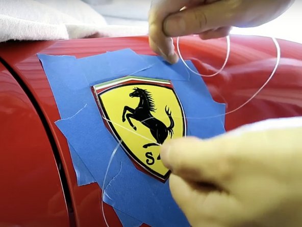

    2. Debadging a Ferrari, Line the badge with masking tape: crwdns2935265:02crwdnd2935265:01crwdnd2935265:01crwdne2935265:0
      • Line the badge of your Ferrari with masking tape as shown.
      • This is done to protect the surrounding paint during the removal process.
    3. Debadging a Ferrari, Soften your adhesive with the heat gun: crwdns2935265:03crwdnd2935265:01crwdnd2935265:01crwdne2935265:0
      • Warm up the badge using your heat gun.
      • Take care not to over heat the badge! You're only softening the adhesive underneath the badge, not cooking it.
      • Think of how warm the exterior of a car gets when it sits out in the sun during the summer. That will act as your reference point.
    4. Debadging a Ferrari, Cutting your adhesive: crwdns2935265:04crwdnd2935265:01crwdnd2935265:02crwdne2935265:0 Debadging a Ferrari, Cutting your adhesive: crwdns2935265:04crwdnd2935265:02crwdnd2935265:02crwdne2935265:0
      • Using the plastic prying tool, carefully pry up one corner of the badge, and slip the floss underneath.
      • You don't want to use too much force on the prying tool, as this can result in denting.
      • Draw the floss back and forth in a sawing motion and simultaneously pull it along the perimeter of the badge until it detaches from the panel.
      • Do not use metal fishing line or metal wires, as these will damage your paint.
