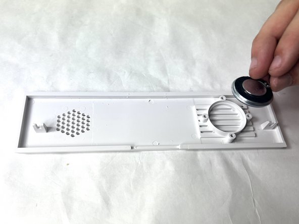

    • Slide the back panel with the speaker up from the bottom case of the project.

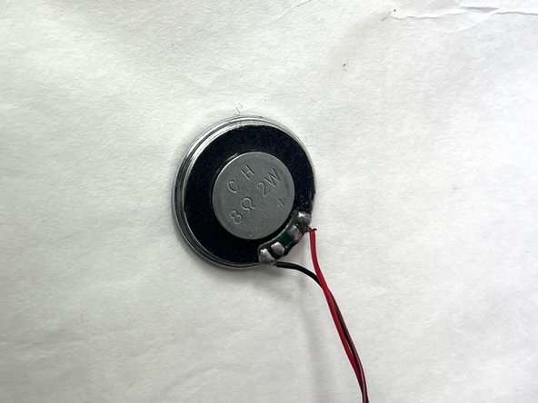

  9. DR.J Professional HI-04 Speaker Replacement: crwdns2935265:09crwdnd2935265:01crwdnd2935265:03crwdne2935265:0 DR.J Professional HI-04 Speaker Replacement: crwdns2935265:09crwdnd2935265:02crwdnd2935265:03crwdne2935265:0 DR.J Professional HI-04 Speaker Replacement: crwdns2935265:09crwdnd2935265:03crwdnd2935265:03crwdne2935265:0
    • Use a Phillips #0 screwdriver to remove the two 10.0 mm screws that secure the speaker.
