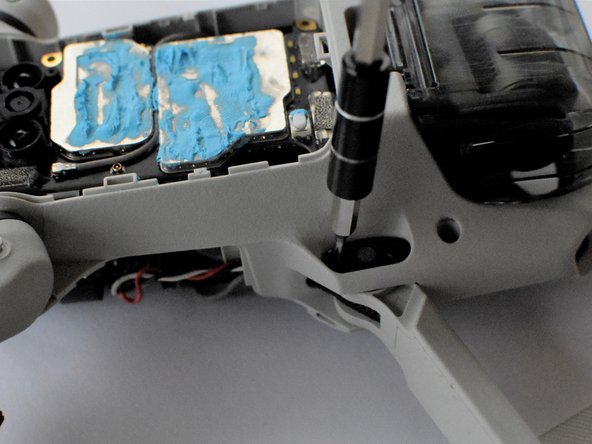

    • Try to avoid disturbing the blue thermal paste covering two of the large board components. If the paste is disturbed or splotchy in places it may need to be removed and reapplied. For more information refer to the How to Apply Thermal Paste guide.
    • Using ESD Safe Tweezers Blunt Nose, remove the two gray coaxial cables attached to the main board.

    • Flip the drone over so that it is right-side up. Then, use a soldering kit to remove the black, red, and white cables from the motherboard.
    • Trace the black, red, and white wires to make sure they are the wires connected to the drone arm you are replacing.

    • Remove the two 3.5mm J000 screws from the drone arm being replaced.
  14. DJI Mini 2 Drone Arm Replacement: crwdns2935265:014crwdnd2935265:01crwdnd2935265:02crwdne2935265:0 DJI Mini 2 Drone Arm Replacement: crwdns2935265:014crwdnd2935265:02crwdnd2935265:02crwdne2935265:0
    • Flip the drone back over and use the tweezers to apply pressure to the pin of the drone arm.
    • Turn the drone back over again and use the tweezers to pull out the drone arm pin.

complete and comprehensive guide, Easy to follow.
Only two small points of critique,
On step 5 It says "Use a combination of the opening tool and your fingers to pry open the top panel of the drone along the seams."
This seemed almost impossible to do withcout damaging the plastic.
I then found a youtube video that showcased that you can unclip a few lips inside the drone, this made the cover come off much easyer.
The video also showed an easyer whay to put the pint removed in step 14 back in.
Apart form these two tips, the guide is practically perfect
The video is by: J T
https://youtu.be/PD678snE44w
Kobe wauters - crwdns2934203:0crwdne2934203:0
Thanks that was just want i needed.
Soren Helmer Jensen -
Great guide! Note that if you are replacing one of the rear arms of the drone, you can skip Steps 6 to 11. Since the rear arms don't contain any radio antennae (only the front arms do), there is no need to access/disconnect those grey coax cables or to remove bottom panel at all. (You might only risk messing up the thermal paste and cause heat issues in longer flights.)
So if you're replacing one of the rear arms, once you removed the top panel (Step 5) you can get soldering right away (Step 13).
Hope that's useful to someone. Great walkthrough though!
