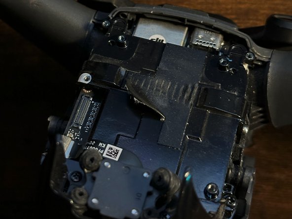

  3. DJI FPV Drone Camera/Gimbal Replacement, Removing the gimbal: crwdns2935265:03crwdnd2935265:01crwdnd2935265:03crwdne2935265:0 DJI FPV Drone Camera/Gimbal Replacement, Removing the gimbal: crwdns2935265:03crwdnd2935265:02crwdnd2935265:03crwdne2935265:0 DJI FPV Drone Camera/Gimbal Replacement, Removing the gimbal: crwdns2935265:03crwdnd2935265:03crwdnd2935265:03crwdne2935265:0
    • Remove 4 screws securing the gimbal.
    • Remove 2 screws securing a retaining clip and lift it off.
    • Lift off the two press-in connectors under the clip, then gently peel the black sticky tape, allowing the gimbal and its cable to be removed.

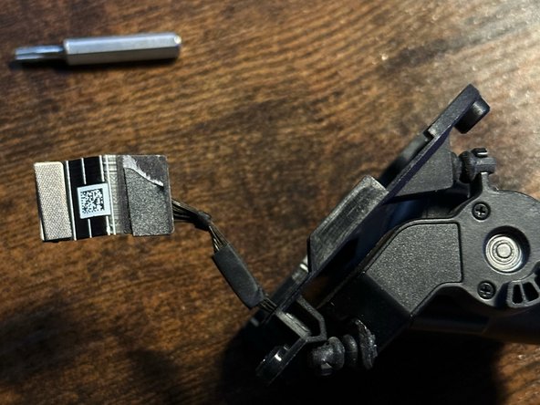

  19. DJI FPV Drone Camera/Gimbal Replacement, Remove the cable cover: crwdns2935265:019crwdnd2935265:01crwdnd2935265:03crwdne2935265:0 DJI FPV Drone Camera/Gimbal Replacement, Remove the cable cover: crwdns2935265:019crwdnd2935265:02crwdnd2935265:03crwdne2935265:0 DJI FPV Drone Camera/Gimbal Replacement, Remove the cable cover: crwdns2935265:019crwdnd2935265:03crwdnd2935265:03crwdne2935265:0
    • Using your T6 screwdriver, remove the two screws that secure the cable cover and set the cover to the side.
    • Using your ESD-safe pry tool, disconnect the camera from it's socket by applying gentle upward pressure.
    • The camera cable is also secured to the drone's housing with adhesive, so you will need to carefully separate the wire from the adhesive on the drone housing.
    • It is OK if you rip away some of the adhesive – it is quite strong.
