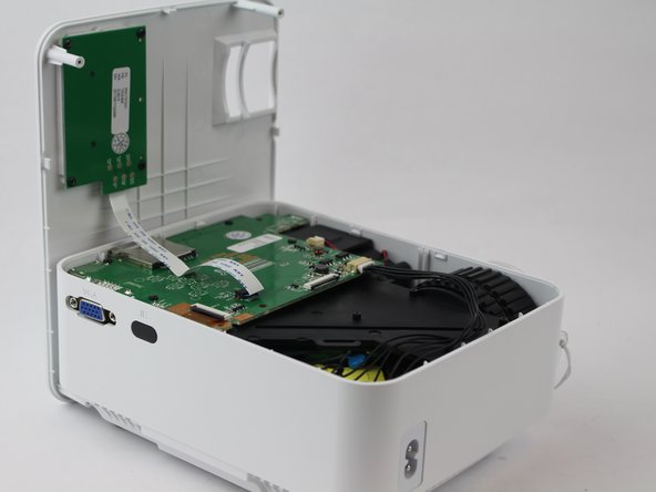

    • Flip the device over and pry the top off with a plastic opening tool.
  4. DBPOWER T20 Lamp Replacement: crwdns2935265:04crwdnd2935265:01crwdnd2935265:01crwdne2935265:0

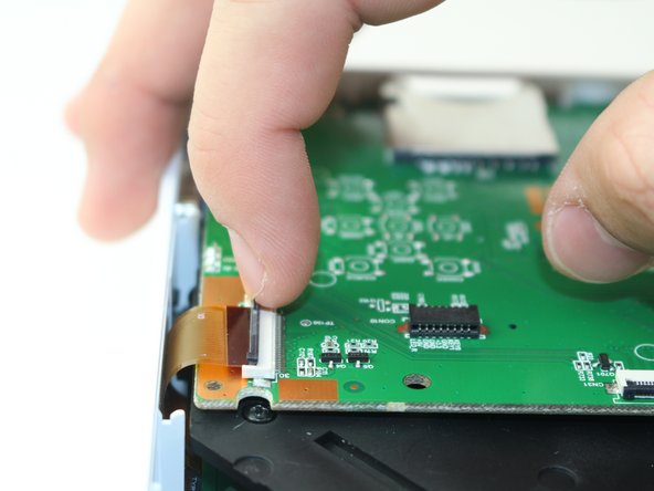

    • Remove the ribbon cable connecting the motherboard to the button control board by gently pulling it from its connector.

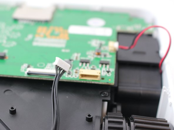

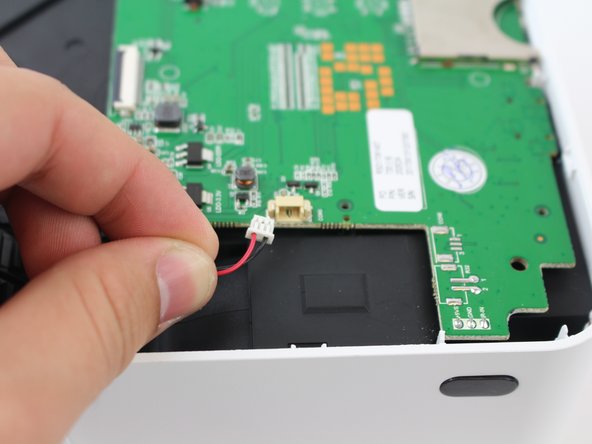

    • Remove the two cables connected to the motherboard: black power cable and the red/black fan cable.
    • the black cable requires more force to remove than the other cables.

    • Lift the black latch on the ZIF connector and remove the ribbon cable that attaches the digitizer to the motherboard.

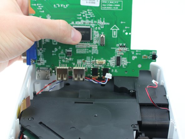

    • Raise motherboard by lifting sideways and then up to avoid the ports.
  9. DBPOWER T20 Lamp Replacement: crwdns2935265:09crwdnd2935265:01crwdnd2935265:02crwdne2935265:0 DBPOWER T20 Lamp Replacement: crwdns2935265:09crwdnd2935265:02crwdnd2935265:02crwdne2935265:0

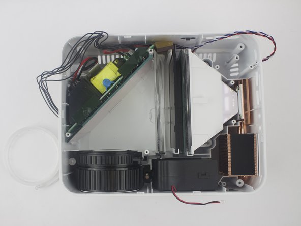

    • Remove the five screws securing the black plastic cover with a J0 screwdriver.
    • Lift up and out to remove.
  11. DBPOWER T20 Lamp Replacement, Lamp: crwdns2935265:011crwdnd2935265:01crwdnd2935265:01crwdne2935265:0
    • Remove the two screws attached to the lamp with a J0 screwdriver.
  12. DBPOWER T20 Lamp Replacement: crwdns2935265:012crwdnd2935265:01crwdnd2935265:01crwdne2935265:0
    • Lift upwards to remove the lamp.
