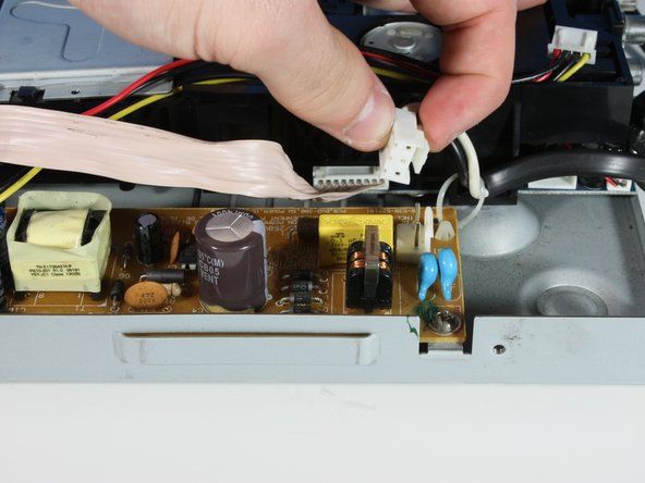

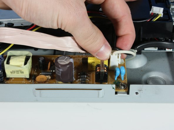

    • Orient the device to locate the power supply board on the far right corner. Use needle nose pliers to pull the white connector from the power supply board.
    • The power supply board is connected directly to the power cord. This is not the same thing as the mother board.

Mine had a bad 2200uf 10v capacitor… I replaced it and the player works fine.

So what capacitor have u replaced ?

I need another power supply board. Mine has 4 blown Capacitors and do not know if any resisters or diodes or small capacitors are bad because I have now testing tools to check them. Just what I see with eyes. Am a retired electronics professional (79) and know what I am doing. Please let me know if I can get a power supply board and the cost. Thank You .
