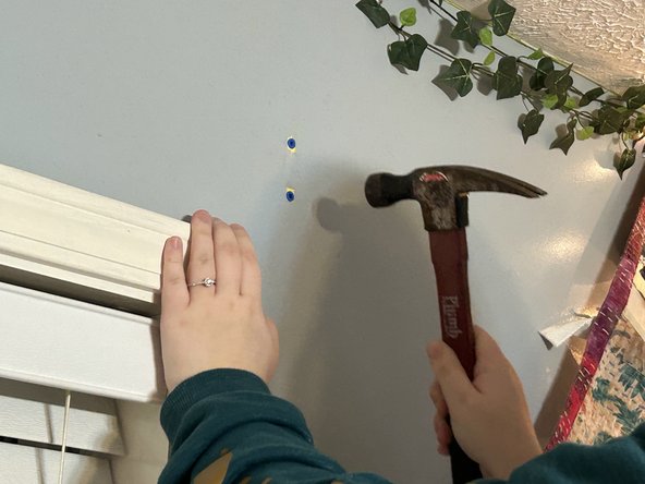

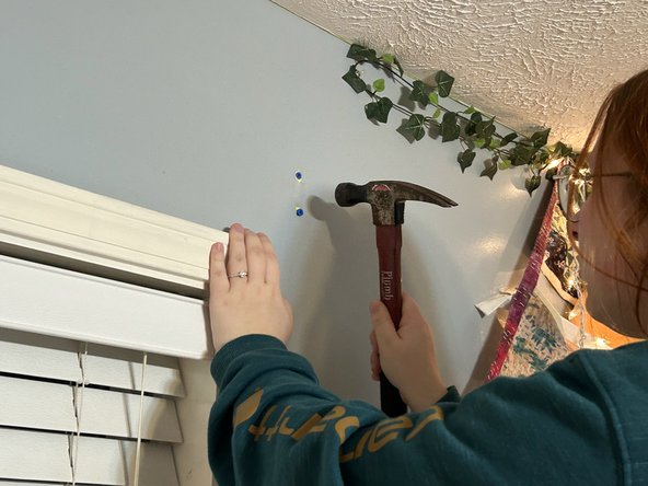

  4. Curtain Rod Bracket Replacement: crwdns2935265:04crwdnd2935265:01crwdnd2935265:03crwdne2935265:0 Curtain Rod Bracket Replacement: crwdns2935265:04crwdnd2935265:02crwdnd2935265:03crwdne2935265:0 Curtain Rod Bracket Replacement: crwdns2935265:04crwdnd2935265:03crwdnd2935265:03crwdne2935265:0
    • Hammer the hollow wall anchor(s) into the hole until flush with the drywall.
