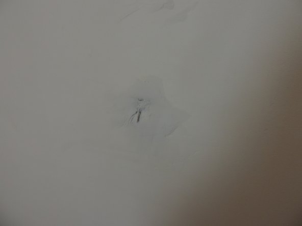

      • Here you have a typical hole. It has broken into the drywall and needs to be repaired.
      • This hole is approximately 2" X 2".

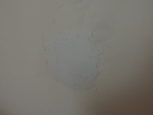

    11. Patching a Hole in Drywall: crwdns2935265:011crwdnd2935265:01crwdnd2935265:01crwdne2935265:0
      • To finish this repair, you will want to apply paint. It will make the finished product more attractive, as seen here.
      • In order to show the repaired hole, only one coat of paint was applied. Add at least 2 coats to fully cover up the repair.
