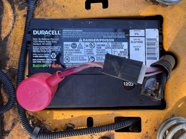

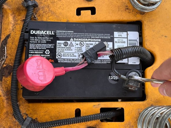

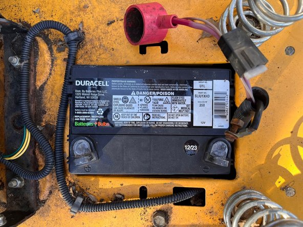

    • Remove the plastic covers from the battery terminals.
    • Use a wrench to disconnect the lawn mower battery terminals.
    • Disconnect the battery by removing the negative (black) terminal first, followed by the positive (red) terminal.
    • When reassembling, reconnect the battery in reverse order: positive terminal first, then negative.

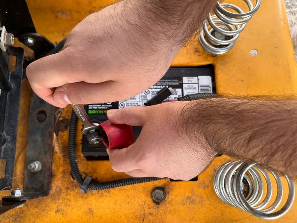

  2. Cub Cadet LT1042 Starter Replacement: crwdns2935265:02crwdnd2935265:01crwdnd2935265:03crwdne2935265:0 Cub Cadet LT1042 Starter Replacement: crwdns2935265:02crwdnd2935265:02crwdnd2935265:03crwdne2935265:0 Cub Cadet LT1042 Starter Replacement: crwdns2935265:02crwdnd2935265:03crwdnd2935265:03crwdne2935265:0

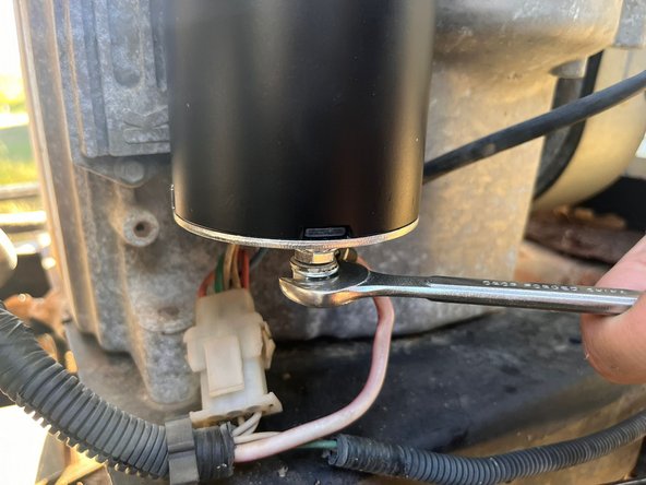

    • Use a wrench to unfasten the cable that connects to the battery.

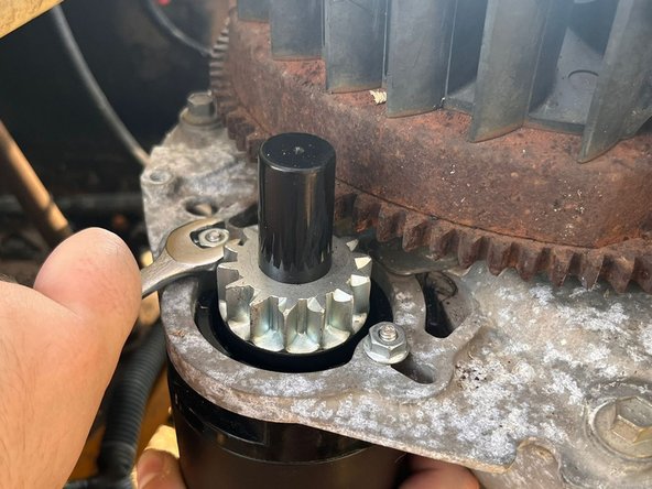

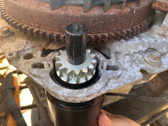

    • Use wrench and unfasten the two top bolts that hold the old starter in place.
  4. Cub Cadet LT1042 Starter Replacement: crwdns2935265:04crwdnd2935265:01crwdnd2935265:02crwdne2935265:0 Cub Cadet LT1042 Starter Replacement: crwdns2935265:04crwdnd2935265:02crwdnd2935265:02crwdne2935265:0

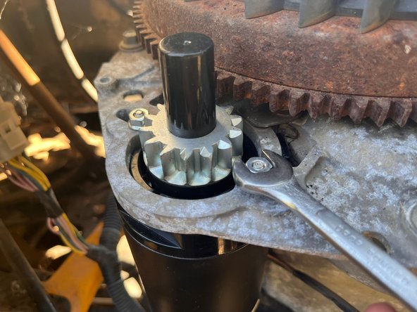

    • Remove the old starter.
    • Replace it with the new starter.
  5. Cub Cadet LT1042 Starter Replacement: crwdns2935265:05crwdnd2935265:01crwdnd2935265:02crwdne2935265:0 Cub Cadet LT1042 Starter Replacement: crwdns2935265:05crwdnd2935265:02crwdnd2935265:02crwdne2935265:0
    • Fasten the new starter in place by tightening the two bolts at the top with the wrench.

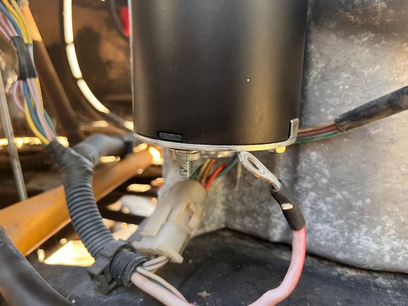

  6. Cub Cadet LT1042 Starter Replacement: crwdns2935265:06crwdnd2935265:01crwdnd2935265:01crwdne2935265:0
    • Refasten the cable that leads to the battery to the bottom bolt of the new starter.

    • Reconnect the battery by fastening the positive (red) terminal first, followed by the negative (black) terminal.
