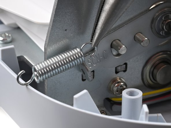

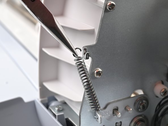

  17. Cricut Maker 3 Rubber Rollers Replacement, Remove the right roller bar spring: crwdns2935265:017crwdnd2935265:01crwdnd2935265:02crwdne2935265:0 Cricut Maker 3 Rubber Rollers Replacement, Remove the right roller bar spring: crwdns2935265:017crwdnd2935265:02crwdnd2935265:02crwdne2935265:0
    • Only grip the spring by the hook on either end. Gripping the middle of the spring can deform it.
    • Make sure to organize and keep track of all of the small parts you'll remove in the next few steps.
    • Use a pair of needle nose pliers to lift the tensioning spring on the right side of the Cricut off of its top post.
  18. Cricut Maker 3 Rubber Rollers Replacement: crwdns2935265:018crwdnd2935265:01crwdnd2935265:02crwdne2935265:0 Cricut Maker 3 Rubber Rollers Replacement: crwdns2935265:018crwdnd2935265:02crwdnd2935265:02crwdne2935265:0
    • Use a pair of needle nose pliers or your fingers to lift the spring off of the roller bar bracket.

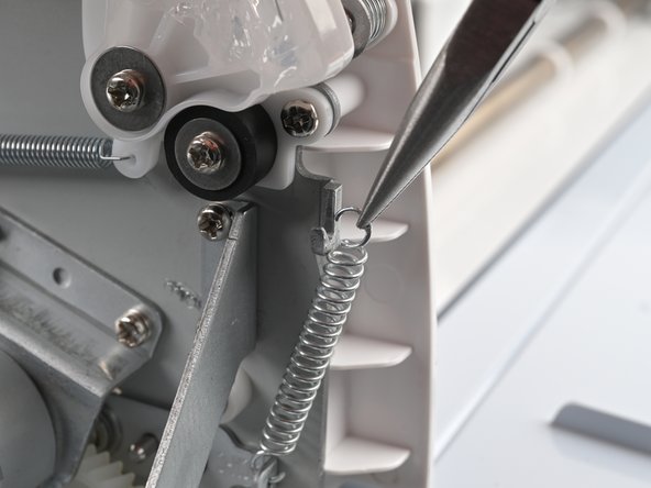

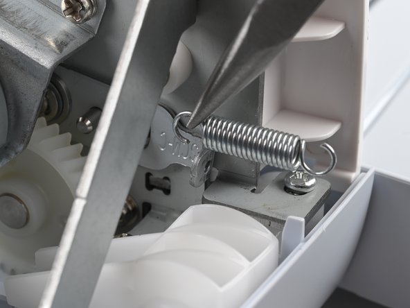

  19. Cricut Maker 3 Rubber Rollers Replacement, Remove the left roller bar spring: crwdns2935265:019crwdnd2935265:01crwdnd2935265:02crwdne2935265:0 Cricut Maker 3 Rubber Rollers Replacement, Remove the left roller bar spring: crwdns2935265:019crwdnd2935265:02crwdnd2935265:02crwdne2935265:0
    • The hinge assembly above the spring contains sticky damping grease. Be careful not to accidentally remove the grease by touching it. If you do accidentally remove some grease, apply more grease before putting the top cover back on.
    • Use a pair of needle nose pliers to lift the tensioning spring on the left side of the Cricut off of its top post.
    • Identify the correct spring by pressing down on the roller bar and noting which spring expands.
  20. Cricut Maker 3 Rubber Rollers Replacement: crwdns2935265:020crwdnd2935265:01crwdnd2935265:02crwdne2935265:0 Cricut Maker 3 Rubber Rollers Replacement: crwdns2935265:020crwdnd2935265:02crwdnd2935265:02crwdne2935265:0

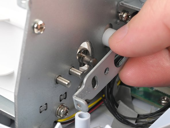

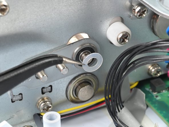

  22. Cricut Maker 3 Rubber Rollers Replacement: crwdns2935265:022crwdnd2935265:01crwdnd2935265:02crwdne2935265:0 Cricut Maker 3 Rubber Rollers Replacement: crwdns2935265:022crwdnd2935265:02crwdnd2935265:02crwdne2935265:0
    • Use a pair of angled tweezers to remove the plastic washer from the right end of the roller bar.
  23. Cricut Maker 3 Rubber Rollers Replacement: crwdns2935265:023crwdnd2935265:01crwdnd2935265:02crwdne2935265:0 Cricut Maker 3 Rubber Rollers Replacement: crwdns2935265:023crwdnd2935265:02crwdnd2935265:02crwdne2935265:0
    • Use a pair of angled tweezers or your fingers to remove the bearing from the roller bar bracket.
  24. Cricut Maker 3 Rubber Rollers Replacement: crwdns2935265:024crwdnd2935265:01crwdnd2935265:02crwdne2935265:0 Cricut Maker 3 Rubber Rollers Replacement: crwdns2935265:024crwdnd2935265:02crwdnd2935265:02crwdne2935265:0
    • Remove the roller bar bracket.

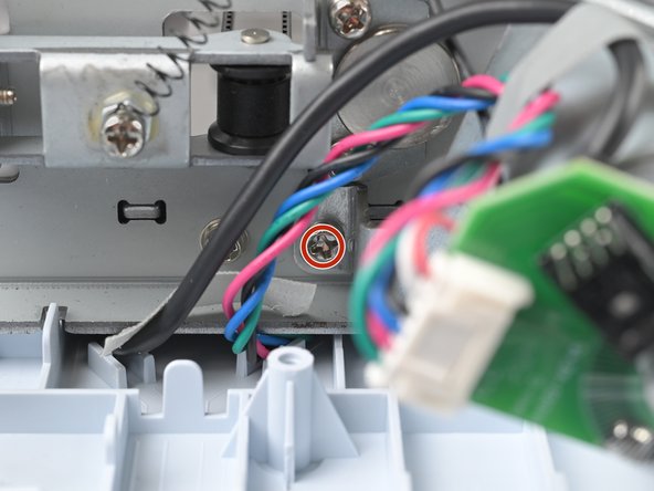

  25. Cricut Maker 3 Rubber Rollers Replacement, Free the left side of the roller bar: crwdns2935265:025crwdnd2935265:01crwdnd2935265:02crwdne2935265:0 Cricut Maker 3 Rubber Rollers Replacement, Free the left side of the roller bar: crwdns2935265:025crwdnd2935265:02crwdnd2935265:02crwdne2935265:0
    • On the left side of the Cricut, use a Phillips screwdriver to remove the three 7.3 mm‑long screws securing the roller bar motor assembly.
    • Be careful not to lose the washer and locking washer under each screw.
    • During reassembly:
    • Make sure each screw has a washer and locking washer, with the locking washer between the washer and the head of the screw.
    • Make sure the grounding wire is secured to the body of the Cricut with the top‑left screw.

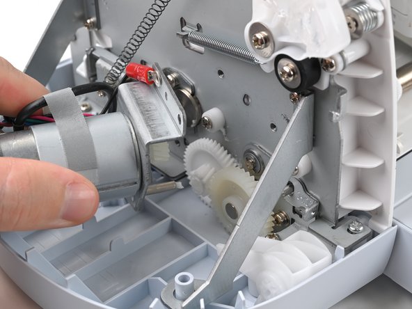

  26. Cricut Maker 3 Rubber Rollers Replacement: crwdns2935265:026crwdnd2935265:01crwdnd2935265:02crwdne2935265:0 Cricut Maker 3 Rubber Rollers Replacement: crwdns2935265:026crwdnd2935265:02crwdnd2935265:02crwdne2935265:0
    • The roller bar motor assembly includes a pin that goes through a gear and into the frame of the Cricut. Pull the assembly straight out to avoid bending this pin.
    • Grab the roller bar motor assembly and move it out of the way.
    • Try to avoid touching the white lithium grease behind the roller bar motor assembly.
    • If the white grease on the pin came off during disassembly, apply a small amount of new grease to the pin before putting the motor assembly back in place.
    • Use paper towels and isopropyl alcohol to clean up any stray grease.
    • Make sure the pin in the motor assembly goes through the gear and into the hole in the frame.

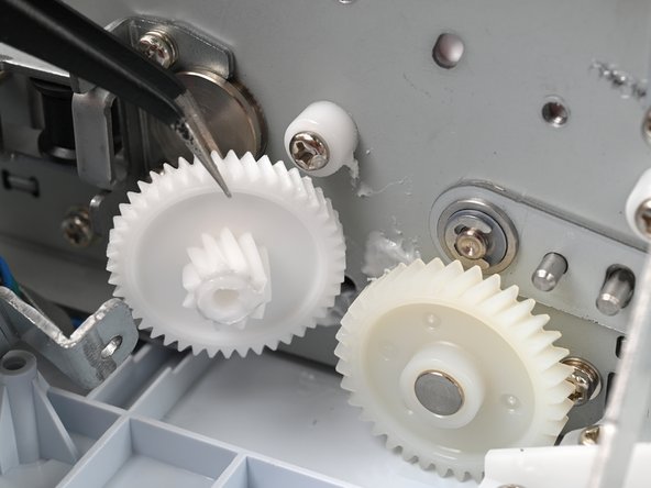

  27. Cricut Maker 3 Rubber Rollers Replacement: crwdns2935265:027crwdnd2935265:01crwdnd2935265:02crwdne2935265:0 Cricut Maker 3 Rubber Rollers Replacement: crwdns2935265:027crwdnd2935265:02crwdnd2935265:02crwdne2935265:0
    • Use a pair of angled tweezers to remove the gear that was secured behind the roller bar motor assembly.

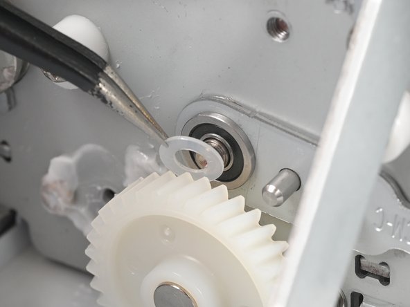

  29. Cricut Maker 3 Rubber Rollers Replacement: crwdns2935265:029crwdnd2935265:01crwdnd2935265:02crwdne2935265:0 Cricut Maker 3 Rubber Rollers Replacement: crwdns2935265:029crwdnd2935265:02crwdnd2935265:02crwdne2935265:0
    • Use a pair of tweezers to remove the plastic washer from the left end of the roller bar.

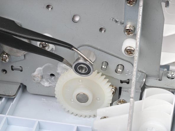

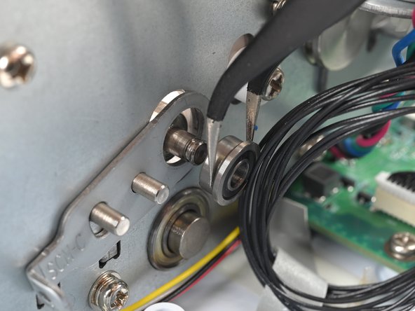

  30. Cricut Maker 3 Rubber Rollers Replacement: crwdns2935265:030crwdnd2935265:01crwdnd2935265:02crwdne2935265:0 Cricut Maker 3 Rubber Rollers Replacement: crwdns2935265:030crwdnd2935265:02crwdnd2935265:02crwdne2935265:0
    • The roller bar bracket is hard to remove and can be left in place.

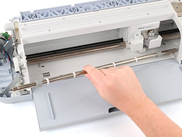

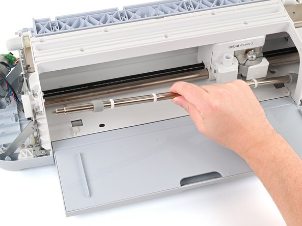

  32. Cricut Maker 3 Rubber Rollers Replacement, Remove the roller bar: crwdns2935265:032crwdnd2935265:01crwdnd2935265:03crwdne2935265:0 Cricut Maker 3 Rubber Rollers Replacement, Remove the roller bar: crwdns2935265:032crwdnd2935265:02crwdnd2935265:03crwdne2935265:0 Cricut Maker 3 Rubber Rollers Replacement, Remove the roller bar: crwdns2935265:032crwdnd2935265:03crwdnd2935265:03crwdne2935265:0
    • Slide the roller bar to the right, making sure it goes through the opening in the right side.
  33. Cricut Maker 3 Rubber Rollers Replacement: crwdns2935265:033crwdnd2935265:01crwdnd2935265:03crwdne2935265:0 Cricut Maker 3 Rubber Rollers Replacement: crwdns2935265:033crwdnd2935265:02crwdnd2935265:03crwdne2935265:0 Cricut Maker 3 Rubber Rollers Replacement: crwdns2935265:033crwdnd2935265:03crwdnd2935265:03crwdne2935265:0
    • Lift the left end of the roller bar up and towards you so it lifts clear of both the side of the Cricut and the tool holder.
    • Slide the roller bar to the left to remove it.

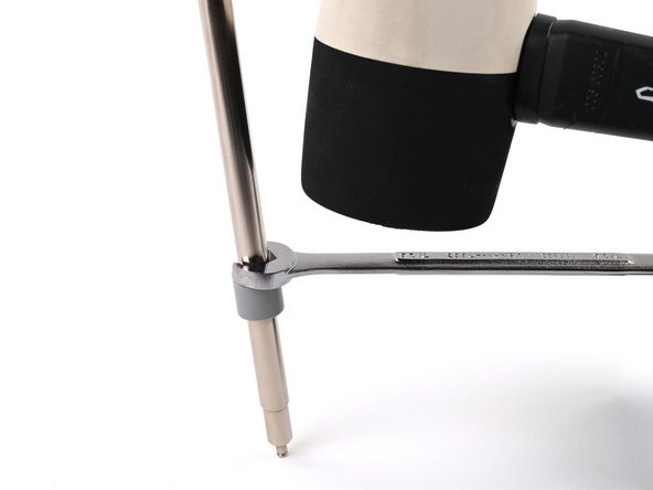

  34. Cricut Maker 3 Rubber Rollers Replacement, Remove the rubber rollers: crwdns2935265:034crwdnd2935265:01crwdnd2935265:02crwdne2935265:0 Cricut Maker 3 Rubber Rollers Replacement, Remove the rubber rollers: crwdns2935265:034crwdnd2935265:02crwdnd2935265:02crwdne2935265:0
    • The rubber rollers are very difficult to remove. If you're replacing them, you can cut them off. If you need to remove them intact, follow these directions.
    • Use a heat gun or hair dryer to heat the rubber roller until it's hot to the touch.
    • After heating, only grab the bar by the cool end.
    • Prop the roller bar up against a sturdy surface or have someone hold it.
    • Before proceeding, make sure your work surface can withstand the next steps. This process may damage your work surface.
    • Place the open end of a wrench around the roller bar, above the rubber roller, so it rests on the roller. The wrench needs to be big enough to fit around the roller bar while still resting on the rubber roller.
    • While holding the wrench with one hand, use a rubber mallet to hit the wrench and push on the rubber roller until it slides off of the bar.
    • During reassembly, follow the instructions included with the replacement rubber rollers. If they did not come with instructions, follow this process in reverse by heating the rubber rollers then using the wrench and mallet to place them.
