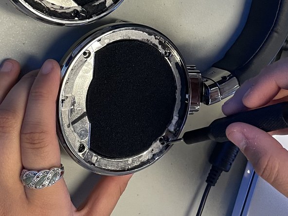

    • Remove the ear pad the with iFixit opening tool.
  2. Cowin E7 I/O Board Replacement: crwdns2935265:02crwdnd2935265:01crwdnd2935265:02crwdne2935265:0 Cowin E7 I/O Board Replacement: crwdns2935265:02crwdnd2935265:02crwdnd2935265:02crwdne2935265:0
    • Unscrew the 6.5 mm screws around the speaker with a Phillips #0 screwdriver.
  3. Cowin E7 I/O Board Replacement: crwdns2935265:03crwdnd2935265:01crwdnd2935265:01crwdne2935265:0
    • Lift up the speaker housing.
  4. Cowin E7 I/O Board Replacement: crwdns2935265:04crwdnd2935265:01crwdnd2935265:01crwdne2935265:0
    • Use a Phillips #0 screwdriver to remove the two 6.5 mm screws that secure the I/O board.
  5. Cowin E7 I/O Board Replacement: crwdns2935265:05crwdnd2935265:01crwdnd2935265:01crwdne2935265:0
    • Disconnect any connected cables then lift the I/O board up and out of the chassis.
