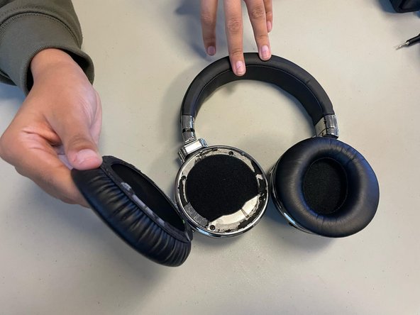

    • Turn the headphones over and use an opening tool to pry up and remove the ear pad.

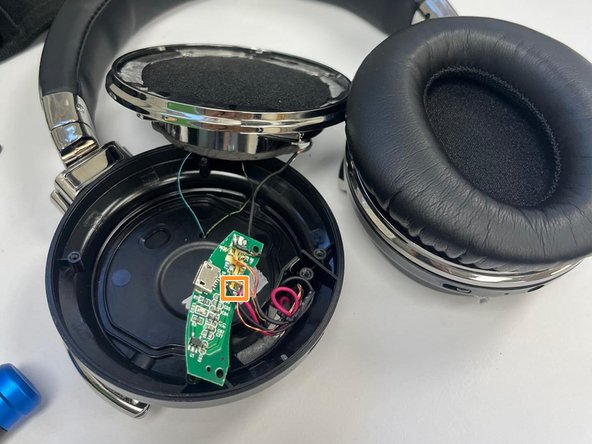

    • Remove the two screws that secure the PCB with a a Phillips #0 screwdriver.
    • Flip the board over, with care not to strain the attached wires.
    • Desolder the battery connections.
    • The battery connections are labeled "BATT."

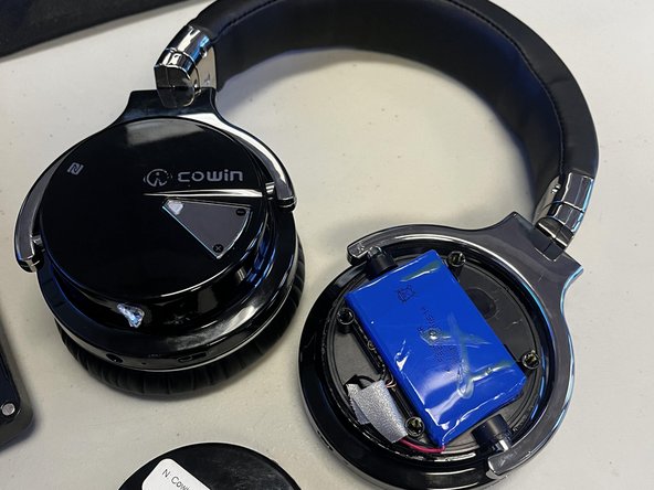

  5. Cowin E7 Battery Replacement: crwdns2935265:05crwdnd2935265:01crwdnd2935265:01crwdne2935265:0
    • Turn the headphones over and remove the battery.
