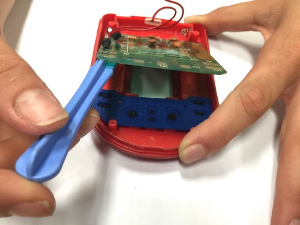

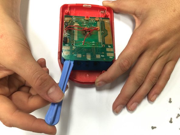

  4. Connect Four Electronic Handheld Screen Replacement, Detaching the circuit board.: crwdns2935265:04crwdnd2935265:01crwdnd2935265:03crwdne2935265:0 Connect Four Electronic Handheld Screen Replacement, Detaching the circuit board.: crwdns2935265:04crwdnd2935265:02crwdnd2935265:03crwdne2935265:0 Connect Four Electronic Handheld Screen Replacement, Detaching the circuit board.: crwdns2935265:04crwdnd2935265:03crwdnd2935265:03crwdne2935265:0
    • Using a Phillips head screwdriver, remove the six (0.25"-length) #3 screws that hold down the cpu board.
    • Using a plastic opening tool, lever the circuit board just enough to where you can easily access the button sheet.

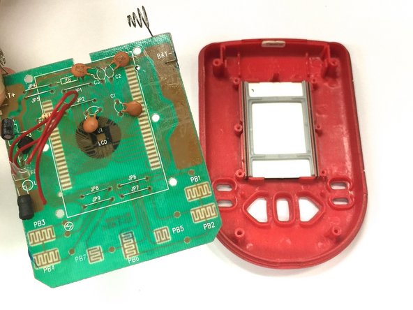

  5. Connect Four Electronic Handheld Screen Replacement, Removing the Circuit Board: crwdns2935265:05crwdnd2935265:01crwdnd2935265:02crwdne2935265:0 Connect Four Electronic Handheld Screen Replacement, Removing the Circuit Board: crwdns2935265:05crwdnd2935265:02crwdnd2935265:02crwdne2935265:0
    • Pop out the wires, connected to the battery terminals, out of their place. You can use a plastic opening tool or fine tweezers for this step.
    • The wires in this image have already been detached.
    • Check that there is no power going into the device that could pose any shock hazard.
    • Once the terminals are out of place, remove the circuit board.
