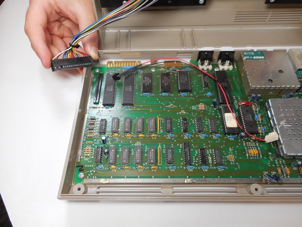

    1. Commodore 64 3AG fuse Replacement, Detach Keyboard from motherboard: crwdns2935265:03crwdnd2935265:01crwdnd2935265:02crwdne2935265:0 Commodore 64 3AG fuse Replacement, Detach Keyboard from motherboard: crwdns2935265:03crwdnd2935265:02crwdnd2935265:02crwdne2935265:0
      • 1. Detach the multi-colored wire bundles that's connected to the motherboard
      • In this picture, the power indication LED (connected to the black and red wires) is not fastened to the keyboard panel, yours might be different.

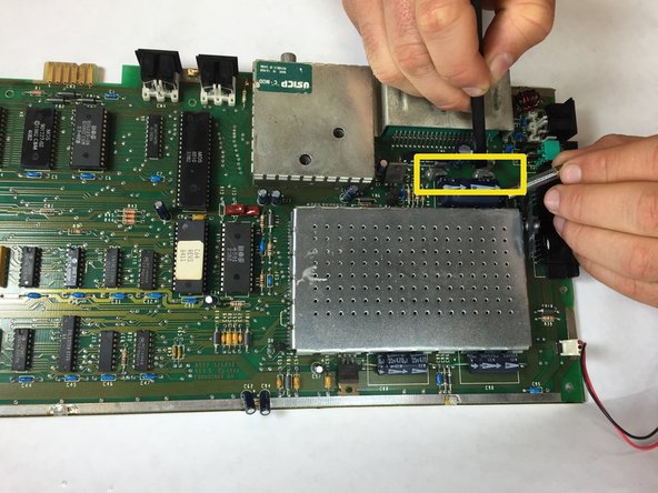

    2. Commodore 64 3AG fuse Replacement, Locate 3AG fuse: crwdns2935265:04crwdnd2935265:01crwdnd2935265:01crwdne2935265:0
      • 2. Find the 3AG fuse located next to the joystick ports and On/Off switch
    3. Commodore 64 3AG fuse Replacement, Removing the 3AG fuse: crwdns2935265:05crwdnd2935265:01crwdnd2935265:02crwdne2935265:0 Commodore 64 3AG fuse Replacement, Removing the 3AG fuse: crwdns2935265:05crwdnd2935265:02crwdnd2935265:02crwdne2935265:0
      • 3. Using the ifixit splugger, prop out the 3AG fuse from the clip.
      • * Replace the 3AG fuse by inserting the new fuse and letting it pop into the clip

3AG does NOT mean a fast acting fuse. It could be either fast or slow blow. The 3 means it's 1 1/4 " long, the "A" means it has Axial connections, and the "G" means it's made of glass.
