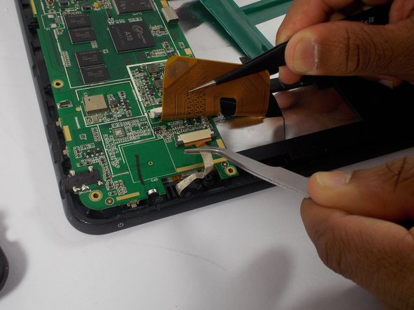

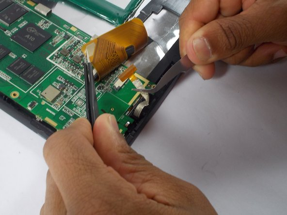

    • Locate the gold flap and use tweezers to lift the flap up.
    • Use a second pair of tweezers to pull the gold tab connected to the camera out of the circuit board.
    • Once the tab is removed from the circuit board, pull the camera out of the tablet.
    • Caution! Be sure to avoid pulling the gold flap off the the circuit board.
