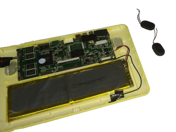

      • Have someone who knows how to solder to do this step.
      • Be careful not to damage the motherboard or other parts in the device.
      • Desolder the wires connecting the speakers to the motherboard from the contact points on the motherboard.
    3. ClickN Kids Tablet Speaker Replacement: crwdns2935265:03crwdnd2935265:01crwdnd2935265:01crwdne2935265:0
      • The speaker is held down with a strong adhesive.
      • Pry the first speaker out of its holding place with a plastic opening tool or spudger.
    4. ClickN Kids Tablet Speaker Replacement: crwdns2935265:04crwdnd2935265:01crwdnd2935265:02crwdne2935265:0 ClickN Kids Tablet Speaker Replacement: crwdns2935265:04crwdnd2935265:02crwdnd2935265:02crwdne2935265:0
      • Pry the second speaker out of its holding place with a plastic opening tool or spudger.
