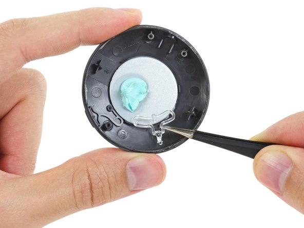

  9. Chromecast 2015 Teardown: crwdns2935265:09crwdnd2935265:01crwdnd2935265:03crwdne2935265:0 Chromecast 2015 Teardown: crwdns2935265:09crwdnd2935265:02crwdnd2935265:03crwdne2935265:0 Chromecast 2015 Teardown: crwdns2935265:09crwdnd2935265:03crwdnd2935265:03crwdne2935265:0
    • Cracking open the Chromecast Audio gives us our first face-to-face with some familiar-looking hardware.
    • Just as in the video-streaming variant, only three Torx screws stand in the way of removing the motherboard.
  10. Chromecast 2015 Teardown: crwdns2935265:010crwdnd2935265:01crwdnd2935265:03crwdne2935265:0 Chromecast 2015 Teardown: crwdns2935265:010crwdnd2935265:02crwdnd2935265:03crwdne2935265:0 Chromecast 2015 Teardown: crwdns2935265:010crwdnd2935265:03crwdnd2935265:03crwdne2935265:0
    • Although the Chromecast 2015 and Audio have some external differences, they're very similar internally—right down to the gobs of baby blue thermal paste.
    • In addition to the heat sink, both models also house two functional plastic bits in the lower case: a light guide for the LED indicator light, and a nifty lil' reset button.
