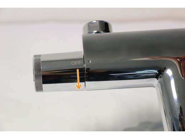

    • WARNING: Before any intervention, make sure that the inverter is in the "OFF" position and close the water supply to the meter.
    • Using a flat screwdriver, unclip the cover to access the handle fixing screw.
    • Unscrew the fixing screw counterclockwise.

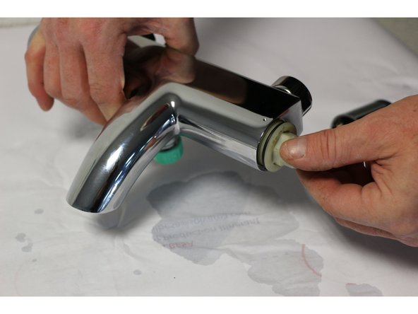

  2. Changing the Bath NF SIRYO CHROME thermostatic cartridge, Dismantling the thermostatic handle: crwdns2935265:02crwdnd2935265:01crwdnd2935265:03crwdne2935265:0 Changing the Bath NF SIRYO CHROME thermostatic cartridge, Dismantling the thermostatic handle: crwdns2935265:02crwdnd2935265:02crwdnd2935265:03crwdne2935265:0 Changing the Bath NF SIRYO CHROME thermostatic cartridge, Dismantling the thermostatic handle: crwdns2935265:02crwdnd2935265:03crwdnd2935265:03crwdne2935265:0
    • Before disassembling, check that the mark on the mixer tap is aligned with the "38°" position, then remove the handle.
    • ATTENTION: before extracting the stop ring (38°), check that the two notches are aligned with the mark on the mixer
    • Extract the thrust ring

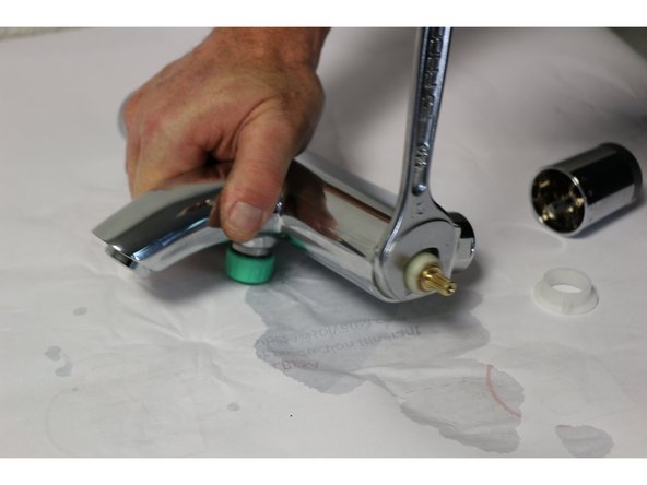

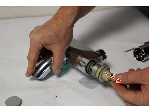

  3. Changing the Bath NF SIRYO CHROME thermostatic cartridge, Removing the thermostatic cartridge: crwdns2935265:03crwdnd2935265:01crwdnd2935265:03crwdne2935265:0 Changing the Bath NF SIRYO CHROME thermostatic cartridge, Removing the thermostatic cartridge: crwdns2935265:03crwdnd2935265:02crwdnd2935265:03crwdne2935265:0 Changing the Bath NF SIRYO CHROME thermostatic cartridge, Removing the thermostatic cartridge: crwdns2935265:03crwdnd2935265:03crwdnd2935265:03crwdne2935265:0
    • Unscrew the thermostatic cartridge anti-clockwise using a 21 wrench.
    • Extract the cartridge by hand.
  4. Changing the Bath NF SIRYO CHROME thermostatic cartridge, Reassembly: crwdns2935265:04crwdnd2935265:01crwdnd2935265:03crwdne2935265:0 Changing the Bath NF SIRYO CHROME thermostatic cartridge, Reassembly: crwdns2935265:04crwdnd2935265:02crwdnd2935265:03crwdne2935265:0 Changing the Bath NF SIRYO CHROME thermostatic cartridge, Reassembly: crwdns2935265:04crwdnd2935265:03crwdnd2935265:03crwdne2935265:0
    • Insert the thermostat in the mixer body.
    • Screw in clockwise by hand.
    • Finish the tightening using the spanner 21.
    • ATTENTION: The tightening torque must not exceed 10Nm. We therefore advise you to use a torque wrench so as not to damage the thread of the thermostatic cartridge.
