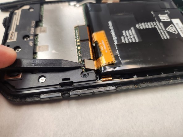

    11. Caterpillar S41 Battery Replacement, Disconnect the Battery: crwdns2935265:011crwdnd2935265:01crwdnd2935265:03crwdne2935265:0 Caterpillar S41 Battery Replacement, Disconnect the Battery: crwdns2935265:011crwdnd2935265:02crwdnd2935265:03crwdne2935265:0 Caterpillar S41 Battery Replacement, Disconnect the Battery: crwdns2935265:011crwdnd2935265:03crwdnd2935265:03crwdne2935265:0
      • Using the tip of your spudger, lift and separate the battery connector from the connection on the motherboard.
      • Lightly bend the connector out of the way to ensure it does not inadvertently cause a connection to be reestablished.

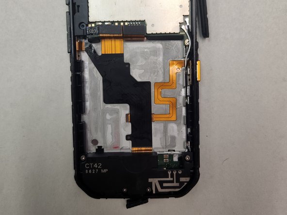

    13. Caterpillar S41 Battery Replacement, Cable Attention: crwdns2935265:013crwdnd2935265:01crwdnd2935265:02crwdne2935265:0 Caterpillar S41 Battery Replacement, Cable Attention: crwdns2935265:013crwdnd2935265:02crwdnd2935265:02crwdne2935265:0
      • Before prying the battery, note this cable.
      • It is highly likely that this cable will stick to the battery. It is still connected within the phone and pulling it up too high can damage the delicate ribbon cable.

    15. Caterpillar S41 Battery Replacement, Cleaning Up: crwdns2935265:015crwdnd2935265:01crwdnd2935265:02crwdne2935265:0 Caterpillar S41 Battery Replacement, Cleaning Up: crwdns2935265:015crwdnd2935265:02crwdnd2935265:02crwdne2935265:0
      • With the battery removed, check for any punctures or damage to the battery and take appropriate precautions as necessary.
      • Clean up the adhesive residue from the battery compartment, and straighten the previously highlighted cable, to prepare for installing the new battery.
