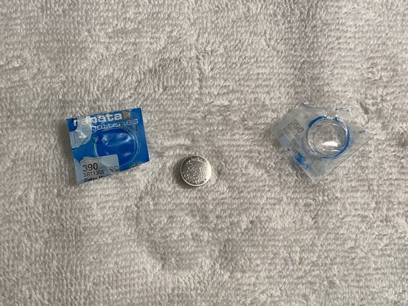

    • Use a pair of tweezers or your fingers to remove the battery from its place.
    • Remove the new battery from its packaging.
  5. Casio G-Shock GA110-1B Battery Replacement: crwdns2935265:06crwdnd2935265:01crwdnd2935265:02crwdne2935265:0 Casio G-Shock GA110-1B Battery Replacement: crwdns2935265:06crwdnd2935265:02crwdnd2935265:02crwdne2935265:0
    • Place the new battery where it belongs with your fingers. Hook it back onto the device to secure it in place.
    • Reattach the white cover onto the device.
