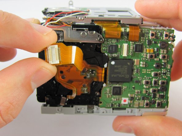

    • Using the iFixit plastic opening tool, pry the battery case clamps on the front of the camera so that the bottom will come loose.
  12. Casio Exilim EX Z55 Motherboard Replacement: crwdns2935265:012crwdnd2935265:01crwdnd2935265:01crwdne2935265:0
    • Detach the inner orange ribbon cable that connects the motherboard to the lens by inserting the iFixit plastic opening tool under the tab and lifting up.
  13. Casio Exilim EX Z55 Motherboard Replacement: crwdns2935265:013crwdnd2935265:01crwdnd2935265:01crwdne2935265:0
    • Separate and remove the motherboard from the lens.
    • It will be still be attached by wires and different orange ribbons.
