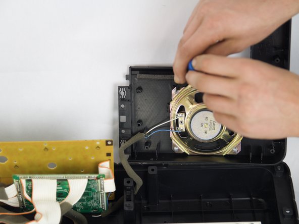

  5. Casio CTK-3200 Speaker Replacement, Speaker: crwdns2935265:05crwdnd2935265:01crwdnd2935265:02crwdne2935265:0 Casio CTK-3200 Speaker Replacement, Speaker: crwdns2935265:05crwdnd2935265:02crwdnd2935265:02crwdne2935265:0
    • Carefully remove the four 10 mm Phillips #1 screws that secure the speaker.
  6. Casio CTK-3200 Speaker Replacement: crwdns2935265:06crwdnd2935265:01crwdnd2935265:01crwdne2935265:0
    • In order to replace the speaker, desolder the wire at the two locations indicated in the photo.
    • To install the the new speaker, you will solder the same wires to the marked locations.
    • In order to safely and correctly solder the new wire, please refer to the soldering guide.
