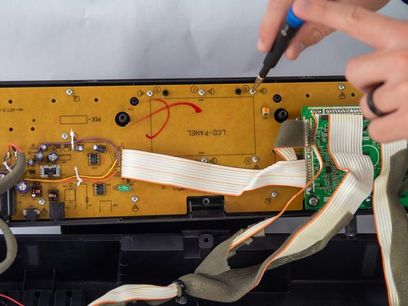

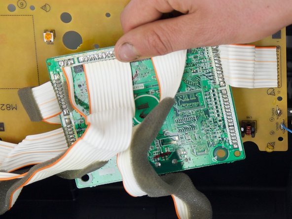

    • Remove the three 12 mm Phillips #2 screws from the green PCB.
    • This step will require you to move some of the motherboard's wiring. Make sure not to separate any of the connection points.
  5. Casio CTK-3200 Main Board Replacement: crwdns2935265:05crwdnd2935265:01crwdnd2935265:02crwdne2935265:0 Casio CTK-3200 Main Board Replacement: crwdns2935265:05crwdnd2935265:02crwdnd2935265:02crwdne2935265:0
    • Remove all twenty-three of the 10 mm Phillips #1 screws from the yellow circuit board.
  6. Casio CTK-3200 Main Board Replacement: crwdns2935265:06crwdnd2935265:01crwdnd2935265:01crwdne2935265:0
    • The board is now able to be removed from the center front panel. Carefully remove the board, making certain not to break the board or any of the components attached to it.
    • Make sure the center front panel is facing down for this step, as the keys will come loose from the front of the panel.
