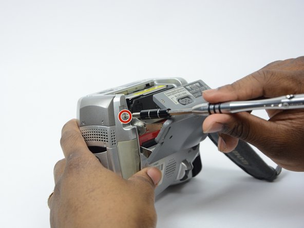

    • Unscrew the 3.35mm screw.

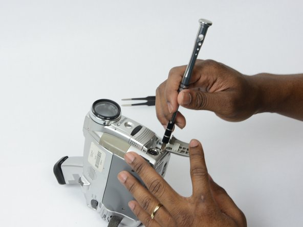

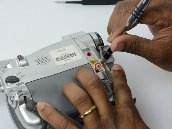

    • Turn the ZR70MC so that you can see the bottom of the camcorder.
    • Unscrew the 3.35 mm located in the top left portion of the camera.

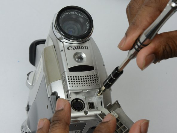

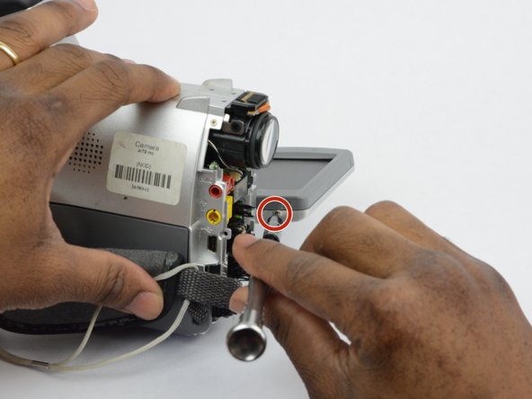

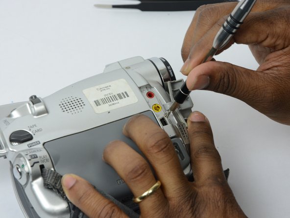

    • Turn the camera on the side and remove the cover for the audio inputs. There is a 2.65 mm screw located behind the cover.
    • Remove the 2.65 mm screw.

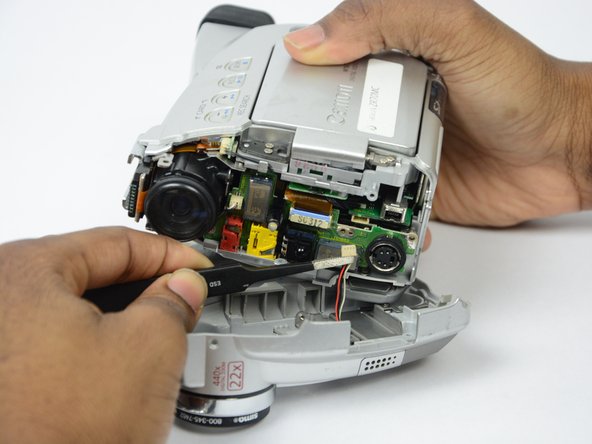

  4. Canon ZR70MC LCD Component Replacement: crwdns2935265:04crwdnd2935265:01crwdnd2935265:03crwdne2935265:0 Canon ZR70MC LCD Component Replacement: crwdns2935265:04crwdnd2935265:02crwdnd2935265:03crwdne2935265:0 Canon ZR70MC LCD Component Replacement: crwdns2935265:04crwdnd2935265:03crwdnd2935265:03crwdne2935265:0
    • Remove the cover located on the front of the camcorder and remove the cover by pulling on the bottom groove.
    • Locate and remove the two 3.35 mm screws.

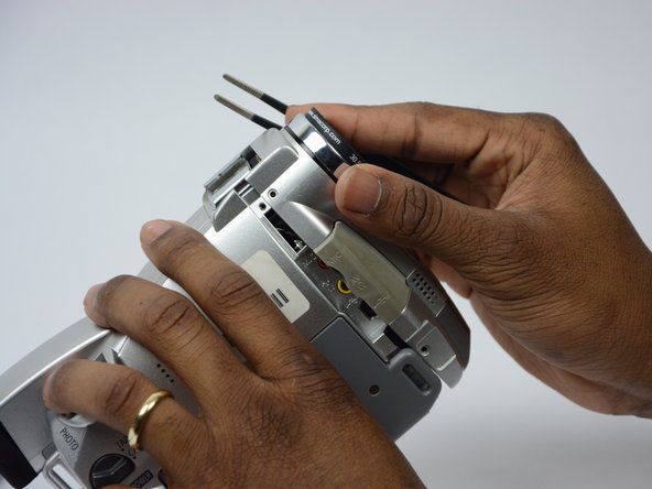

    • Turn the camcorder so that the bottom is facing up and open the tape cassette compartment.
    • There is one 3.35 mm screw located under the tape cassette panel on the front left side of the camcorder. Remove the screw.

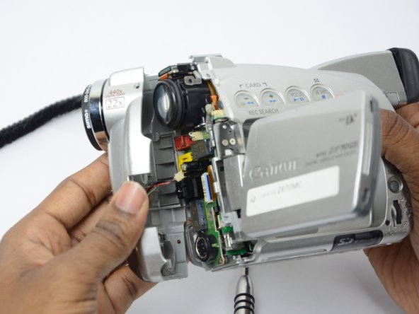

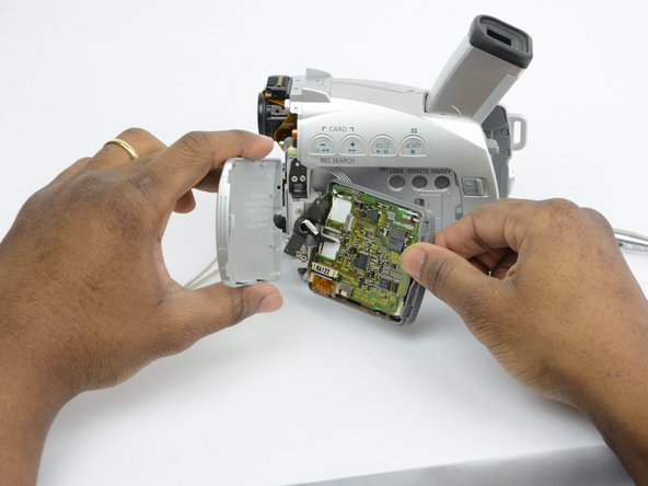

    • Now that all of the screws are removed, remove the front panel by gently pulling on the front panel.
    • The speaker will be connected to the main body by a wire. Be careful not to damage this wire.

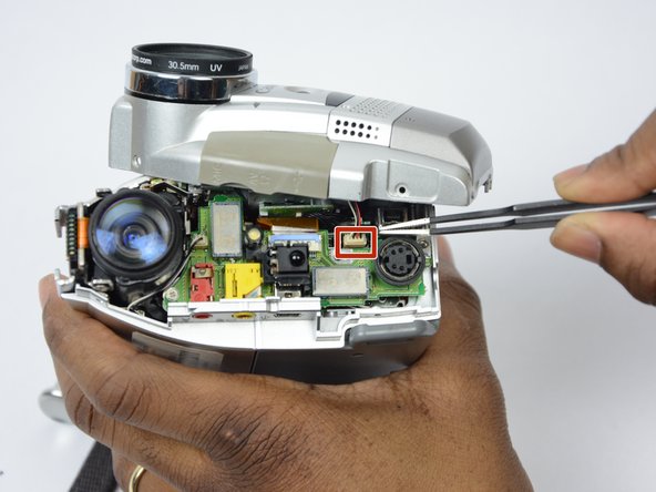

  7. Canon ZR70MC LCD Component Replacement: crwdns2935265:07crwdnd2935265:01crwdnd2935265:03crwdne2935265:0 Canon ZR70MC LCD Component Replacement: crwdns2935265:07crwdnd2935265:02crwdnd2935265:03crwdne2935265:0 Canon ZR70MC LCD Component Replacement: crwdns2935265:07crwdnd2935265:03crwdnd2935265:03crwdne2935265:0
    • Use tweezers to gently pull the speaker wire from the main body of the camcorder.
    • Pull the front panel completely away from the main body of the camcorder.

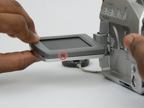

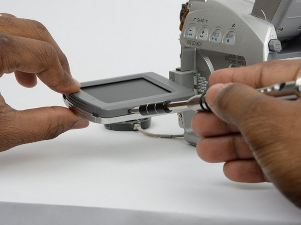

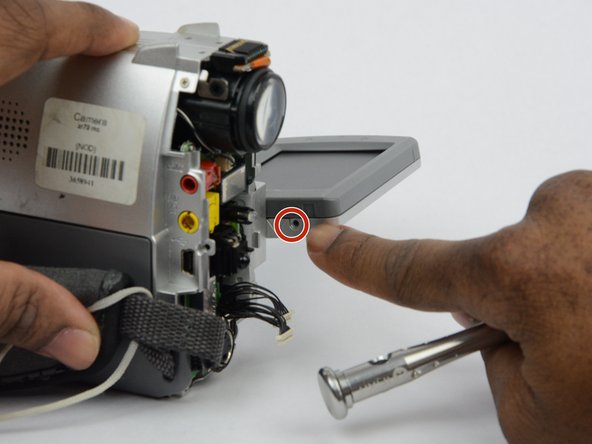

    • Open the LCD screen.
    • Locate and remove the 2.7 mm screw on the bottom of the LCD monitor.

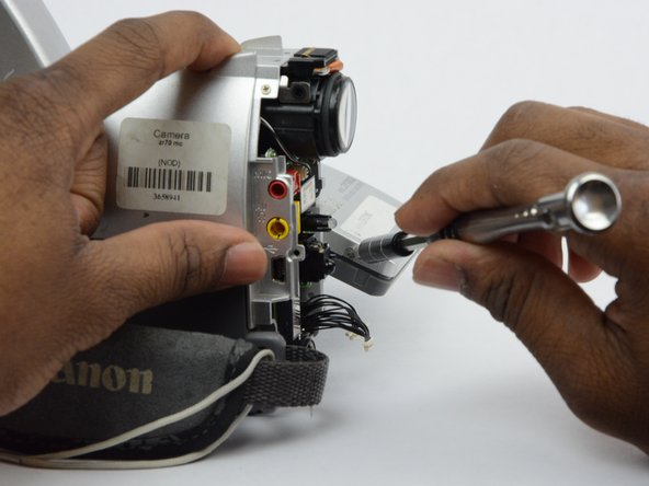

    • Turn the LCD monitor so that the screen is facing down.
    • There is a 2.7 mm screw on the LCD monitor where the monitor is connected to the main body of the camcorder. Remove the 2.7 mm screw.

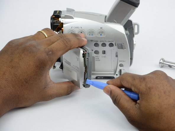

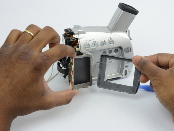

    • Now that all the screws are removed, use the plastic opening tool to gently pry the LCD monitor case open.
  12. Canon ZR70MC LCD Component Replacement: crwdns2935265:012crwdnd2935265:01crwdnd2935265:03crwdne2935265:0 Canon ZR70MC LCD Component Replacement: crwdns2935265:012crwdnd2935265:02crwdnd2935265:03crwdne2935265:0 Canon ZR70MC LCD Component Replacement: crwdns2935265:012crwdnd2935265:03crwdnd2935265:03crwdne2935265:0

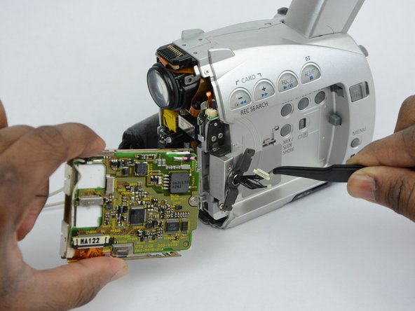

    • Use tweezers to remove the wire connections that hold the LCD screen in place.
    • Remove the entire LCD screen.
