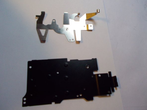

  3. Canon Sure Shot Z115 Best Shot Dial Replacement: crwdns2935265:03crwdnd2935265:01crwdnd2935265:02crwdne2935265:0 Canon Sure Shot Z115 Best Shot Dial Replacement: crwdns2935265:03crwdnd2935265:02crwdnd2935265:02crwdne2935265:0
    • Locate the metal tab sticking up from underneath the black plastic.
    • Gently pull the tab to remove the black plastic along with the metal part underneath.

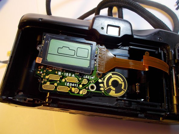

  4. Canon Sure Shot Z115 Best Shot Dial Replacement: crwdns2935265:04crwdnd2935265:01crwdnd2935265:01crwdne2935265:0
    • Find the black plastic cover that protects the display logic board.
    • You will see a flat orange cable extending from underneath the cover.
    • Remove the screw circled in red.
  5. Canon Sure Shot Z115 Best Shot Dial Replacement: crwdns2935265:05crwdnd2935265:01crwdnd2935265:02crwdne2935265:0 Canon Sure Shot Z115 Best Shot Dial Replacement: crwdns2935265:05crwdnd2935265:02crwdnd2935265:02crwdne2935265:0
    • Gently pull the orange cable to lift the logic board out.
    • Move the logic board out of the way so you can see the screw that holds the dial in place.
    • Be careful when moving the logic board. Avoid touching the top of the board. Make sure that if you put the board down on top of something that the black plastic is still stuck to the bottom (as shown in the second picture).
