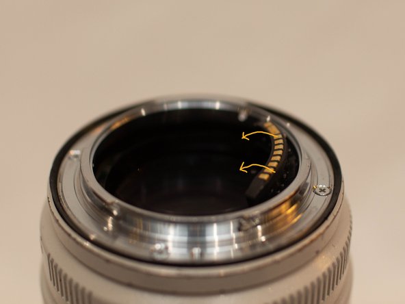

    • Unscrew the four Phillips #00 screws around the inner part of the lens mount:
    • Carefully pull up around the inside edge of the back cover (the black plastic piece inside of the lens mount). The cover should be able to pop out without too much force.
    • Gently push the electrical connector away from the lens mount, so that it is resting off of the lens mount.

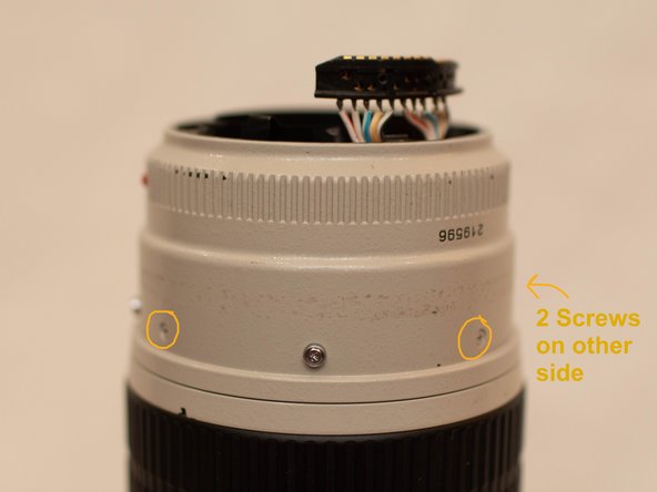

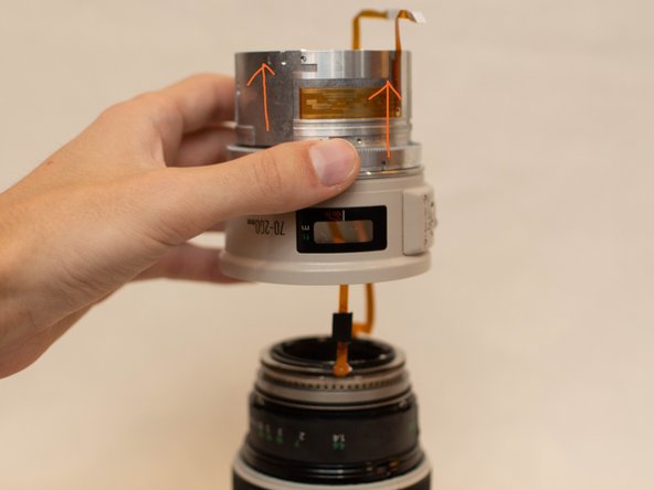

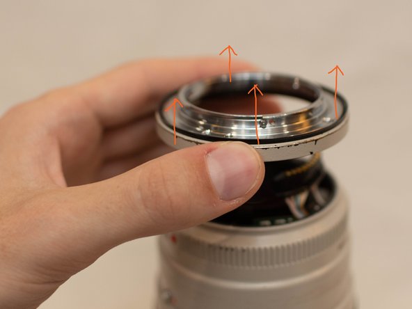

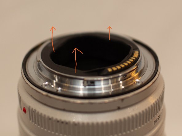

  3. Canon EF 70-200mm f/2.8L IS USM Zooming Key Replacement, Remove the Lens Mount & Fixed Barrel: crwdns2935265:03crwdnd2935265:01crwdnd2935265:03crwdne2935265:0 Canon EF 70-200mm f/2.8L IS USM Zooming Key Replacement, Remove the Lens Mount & Fixed Barrel: crwdns2935265:03crwdnd2935265:02crwdnd2935265:03crwdne2935265:0 Canon EF 70-200mm f/2.8L IS USM Zooming Key Replacement, Remove the Lens Mount & Fixed Barrel: crwdns2935265:03crwdnd2935265:03crwdnd2935265:03crwdne2935265:0
    • Unscrew the four JIS #000 screws holding in the metal lens mount.
    • Grab the metal ring directly below the lens mount and pull upwards. It is best to keep the metal ring, the lens mount, the lens mount washer, and the weather seal together as taking them apart is not needed.

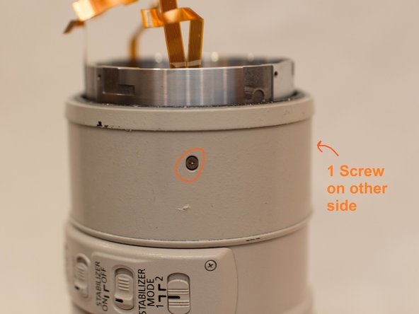

    • Next, remove the four Phillips #00 screws around the outside of the fixed barrel assembly.
    • Be sure to remove the screws that are recessed into the lens, and not the screws that are sticking off of the lens (those ones are only for holding the tripod mount onto the lens).
    • Pull the fixed barrel assembly directly upwards.
    • Use caution while removing the fixed barrel. The main PCB assembly sits around the inside of the fixed barrel, so you don't want to push against it while lifting off the fixed barrel.

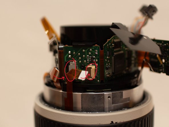

  4. Canon EF 70-200mm f/2.8L IS USM Zooming Key Replacement, Remove Tape Around Main PCB Assembly: crwdns2935265:04crwdnd2935265:01crwdnd2935265:01crwdne2935265:0
    • Steps 4 and 5 involve handling sensitive electronics. Avoid static discharge.
    • Peel up the end of the black tape surrounding the main PCB assembly and very slowly and carefully begin to peel back the tape.
    • Watch out for ribbon cables that the tape may be adhered to. If needed, grab the ribbon cable with a pair of blunt tip tweezers as you peel back the tape.
    • Use extreme care while handling ribbon cables and connectors as they can be easy to damage.
    • Set the tape aside, as it will be placed back during reassembly.

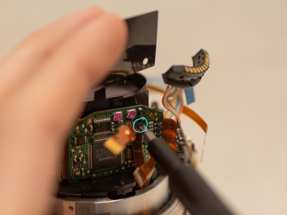

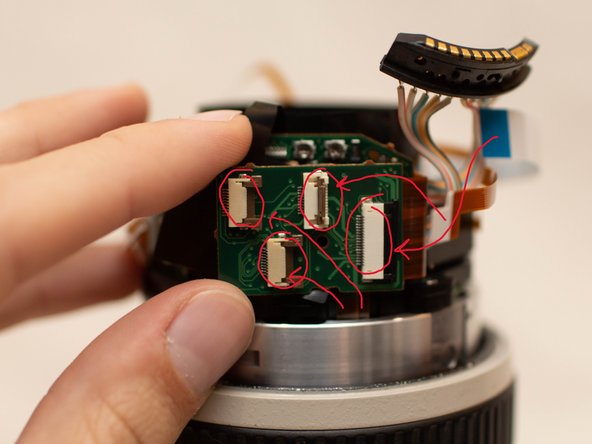

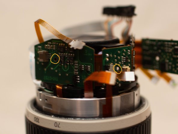

  5. Canon EF 70-200mm f/2.8L IS USM Zooming Key Replacement, Disconnect and Remove the Main PCB Assembly: crwdns2935265:05crwdnd2935265:01crwdnd2935265:03crwdne2935265:0 Canon EF 70-200mm f/2.8L IS USM Zooming Key Replacement, Disconnect and Remove the Main PCB Assembly: crwdns2935265:05crwdnd2935265:02crwdnd2935265:03crwdne2935265:0 Canon EF 70-200mm f/2.8L IS USM Zooming Key Replacement, Disconnect and Remove the Main PCB Assembly: crwdns2935265:05crwdnd2935265:03crwdnd2935265:03crwdne2935265:0
    • On the far right PCB board, you may notice two adjustment knobs (they are designed to be adjusted using a screw driver). DO NOT mess with these knobs. Doing so will cause the autofocus to not be able to properly focus, and unless you're able to learn how to readjust them, you'd have to get your lens professionally serviced to fix it.
    • Carefully disconnect the 7 ribbon cables from the main PCB boards.
    • iFixit connector guide
    • Unscrew the three Phillips #00 screws holding the PCB boards in place.
    • Pull off the black plastic cover.
    • Carefully pull off and set aside the main PCB boards.

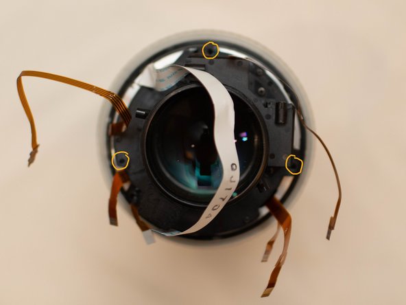

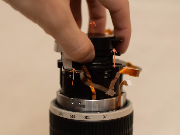

  6. Canon EF 70-200mm f/2.8L IS USM Zooming Key Replacement, Remove the IS Lens Assembly: crwdns2935265:06crwdnd2935265:01crwdnd2935265:02crwdne2935265:0 Canon EF 70-200mm f/2.8L IS USM Zooming Key Replacement, Remove the IS Lens Assembly: crwdns2935265:06crwdnd2935265:02crwdnd2935265:02crwdne2935265:0
    • Unscrew the three silver M2x8mm Phillips #00 screws around the outside edge of the IS lens assembly.
    • Carefully pull the IS lens assembly up and out of the lens. Be careful not to snag any of the ribbon cables.
    • Avoid touching any of the internal lens elements. Your fingers will leave smudges on them. If you touch one by accident, use a microfiber cloth to wipe them off before the lens is reassembled.

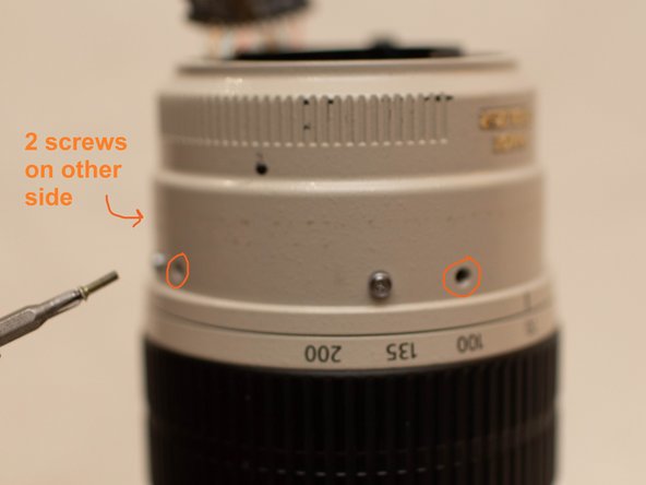

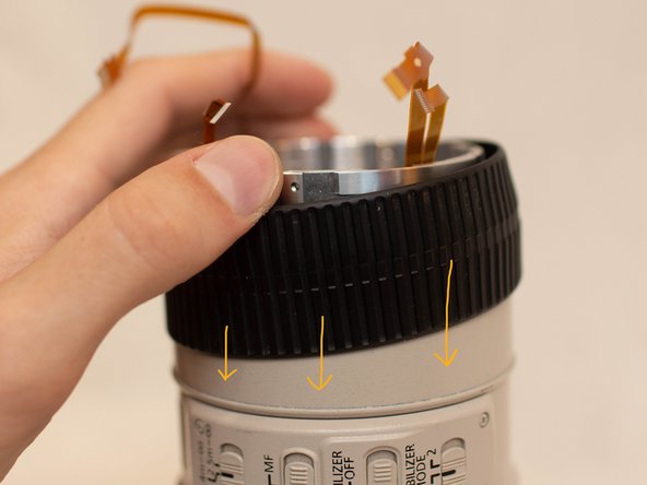

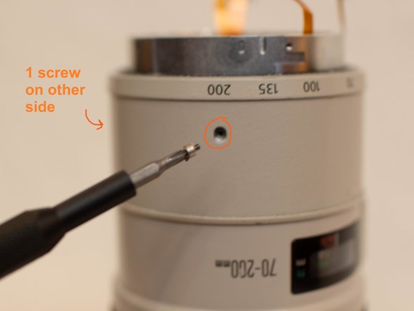

  7. Canon EF 70-200mm f/2.8L IS USM Zooming Key Replacement, Remove the Zoom Ring: crwdns2935265:07crwdnd2935265:01crwdnd2935265:03crwdne2935265:0 Canon EF 70-200mm f/2.8L IS USM Zooming Key Replacement, Remove the Zoom Ring: crwdns2935265:07crwdnd2935265:02crwdnd2935265:03crwdne2935265:0 Canon EF 70-200mm f/2.8L IS USM Zooming Key Replacement, Remove the Zoom Ring: crwdns2935265:07crwdnd2935265:03crwdnd2935265:03crwdne2935265:0
    • Slip a pair of tweezers underneath the rubber zoom grip and work around the grip to get it over the edge of the zoom ring.
    • Continue until the grip is in a position to be able to pull/push it the rest of the way off the lens with your hands.
    • The rubber grip can deteriorate over time and develop cracks or become more delicate. If you notice signs of deterioration, use extra care while removing the grip to avoid breaking it.
    • Remove the two JIS #000 screws that are underneath where the zoom grip was. There is one on each side.
    • Pull the zoom ring straight up and off of the lens.

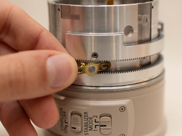

  8. Canon EF 70-200mm f/2.8L IS USM Zooming Key Replacement, Remove Reverse Gears: crwdns2935265:08crwdnd2935265:01crwdnd2935265:02crwdne2935265:0 Canon EF 70-200mm f/2.8L IS USM Zooming Key Replacement, Remove Reverse Gears: crwdns2935265:08crwdnd2935265:02crwdnd2935265:02crwdne2935265:0
    • Underneath the zoom ring are two metal rings with teeth on one side of them. In between the metal rings are 3 plastic gears. Those gears are referred to as the reverse gears.
    • Remove the two M1.7x3mm JIS #000 screws holding in one of the reverse gears.
    • Use a pair of tweezers to pull off the reverse gear.
    • Repeat the previous 2 instructions to remove the other two reverse gears.

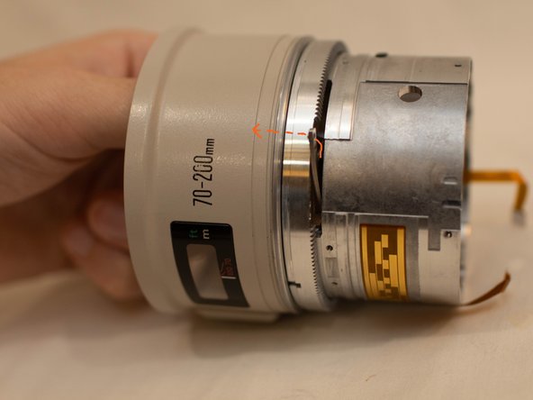

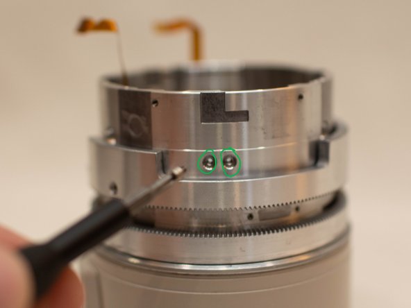

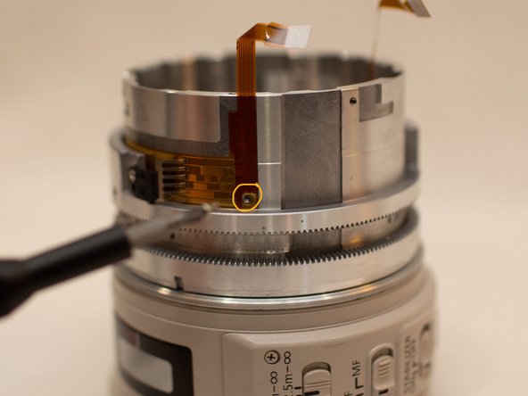

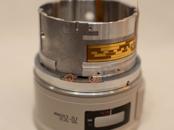

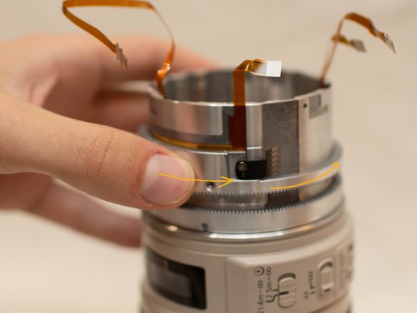

  9. Canon EF 70-200mm f/2.8L IS USM Zooming Key Replacement, Remove Gear Ring 1: crwdns2935265:09crwdnd2935265:01crwdnd2935265:03crwdne2935265:0 Canon EF 70-200mm f/2.8L IS USM Zooming Key Replacement, Remove Gear Ring 1: crwdns2935265:09crwdnd2935265:02crwdnd2935265:03crwdne2935265:0 Canon EF 70-200mm f/2.8L IS USM Zooming Key Replacement, Remove Gear Ring 1: crwdns2935265:09crwdnd2935265:03crwdnd2935265:03crwdne2935265:0
    • Gear ring 1 refers to the upper of the two metal rings (the one closest to the rear of the lens).
    • Remove the Phillips #00 screw holding the zoom ribbon cable in place.
    • Remove the two JIS #000 gear limit screws.
    • Rotate the gear ring 1 as far counter-clockwise as you are able to.
    • Be very careful with the zooming brush, as it is very easily damaged. Make sure it does not snag anything and that the pins do not bend!
    • Pull the gear ring up and off of the lens. You may need to wiggle the ring slightly if it is having troubles coming off.

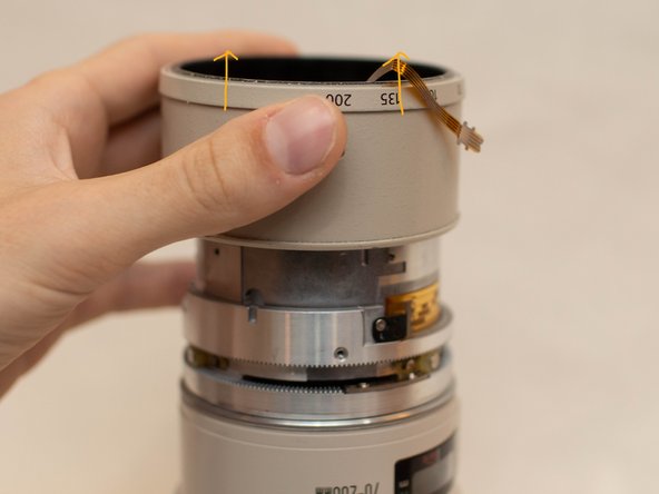

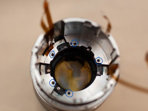

  10. Canon EF 70-200mm f/2.8L IS USM Zooming Key Replacement, Remove the Intermediate Barrel: crwdns2935265:010crwdnd2935265:01crwdnd2935265:02crwdne2935265:0 Canon EF 70-200mm f/2.8L IS USM Zooming Key Replacement, Remove the Intermediate Barrel: crwdns2935265:010crwdnd2935265:02crwdnd2935265:02crwdne2935265:0
    • Unscrew the five M2x6mm Phillips #00 screws holding the intermediate barrel in place.
    • Pull the intermediate barrel up and off of the lens.
    • Be careful of the 2 ribbon cables inside of the intermediate barrel as you pull it off of the lens. Do not let them snag on anything.

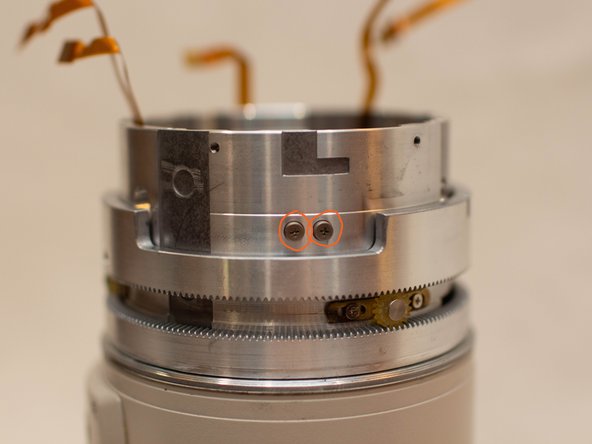

  11. Canon EF 70-200mm f/2.8L IS USM Zooming Key Replacement, Remove the Broken Zooming Key: crwdns2935265:011crwdnd2935265:01crwdnd2935265:02crwdne2935265:0 Canon EF 70-200mm f/2.8L IS USM Zooming Key Replacement, Remove the Broken Zooming Key: crwdns2935265:011crwdnd2935265:02crwdnd2935265:02crwdne2935265:0
    • Remove the two Phillips #00 screws holding in the zooming key.
    • Reach inside of the intermediate barrel with your hand and pull out the zooming key.

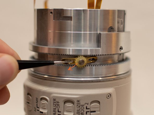

  14. Canon EF 70-200mm f/2.8L IS USM Zooming Key Replacement, Install Reverse Gears: crwdns2935265:014crwdnd2935265:01crwdnd2935265:03crwdne2935265:0 Canon EF 70-200mm f/2.8L IS USM Zooming Key Replacement, Install Reverse Gears: crwdns2935265:014crwdnd2935265:02crwdnd2935265:03crwdne2935265:0 Canon EF 70-200mm f/2.8L IS USM Zooming Key Replacement, Install Reverse Gears: crwdns2935265:014crwdnd2935265:03crwdnd2935265:03crwdne2935265:0
    • Rotate the upper gear ring (the one you just installed) as far clockwise as you can
    • Rotate the lower gear ring as far counter-clockwise as you can.
    • Both of these gear rings must remain in this position while installing the reverse gears or the zoom ring will be misaligned with the zoom mechanics.
    • Insert one of the reverse gears into position, using caution to not move the gear rings.
    • The reverse gears are the 3 plastic gears that go in between the two gear rings.
    • Screw the two M1.7x3mm JIS #000 screws into the reverse gear.
    • Repeat the previous two instructions to install the other 2 reverse gears.

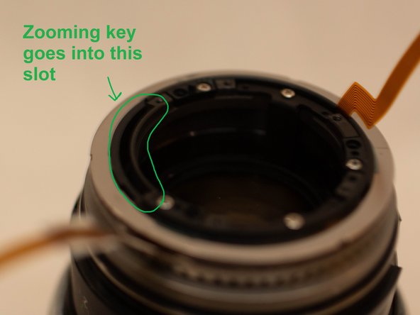

  15. Canon EF 70-200mm f/2.8L IS USM Zooming Key Replacement, Attach the Intermediate Barrel: crwdns2935265:015crwdnd2935265:01crwdnd2935265:03crwdne2935265:0 Canon EF 70-200mm f/2.8L IS USM Zooming Key Replacement, Attach the Intermediate Barrel: crwdns2935265:015crwdnd2935265:02crwdnd2935265:03crwdne2935265:0 Canon EF 70-200mm f/2.8L IS USM Zooming Key Replacement, Attach the Intermediate Barrel: crwdns2935265:015crwdnd2935265:03crwdnd2935265:03crwdne2935265:0
    • Rotate the upper gear ring fully clockwise.
    • Hold the intermediate barrel above the front portion of the lens and feed the 2 long ribbon cables up through the intermediate barrel.
    • Lower the intermediate barrel into place.
    • The zooming key should go into the slot on the front part of the lens.
    • Line up the screw holes on the intermediate barrel and the front of the lens. Also make sure to line up the ribbon cables with the cut outs in bottom of the intermediate barrel.
    • Screw the five M2x6mm Phillips #00 screws into the bottom of the intermediate barrel, locking it onto the front of the lens.
