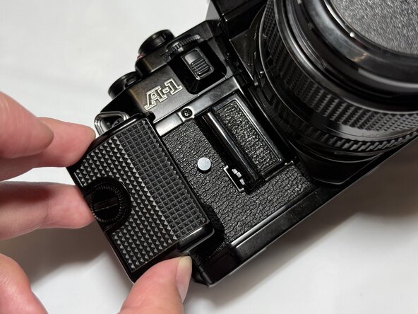

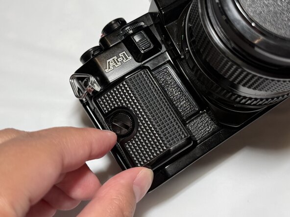

    • In the front left side of the camera, there is a large black screw. Place your fingernail into the indent going across the screw, and use it as leverage to turn the screw counter-clockwise.
    • Once it loosens, drag your finger downwards against the left side of the screw to quickly unscrew it.
    • The screw will not fully come out, so once you think it's out of its socket, gently pull the black plastic action grip to the left. It should very easily slide off.
    • If the action grip does not easily slide off, that may mean the screw is not fully loosened, yet. Keep unscrewing it and try again.

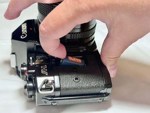

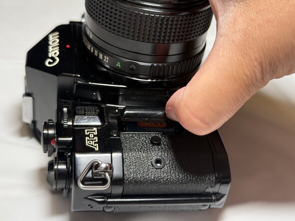

    • Make sure the camera is powered off before completing this step. To do this, make sure the main switch on top of the advance lever is switched to the red "L".
    • Press the button inward towards the camera's lens.
    • Pull the door up towards you, allowing the battery to be exposed.
    • Remove the battery.

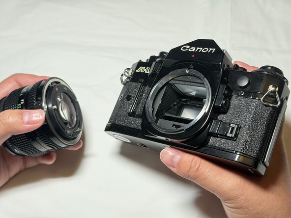

  3. Canon A-1 Light Seal Replacement: crwdns2935265:03crwdnd2935265:01crwdnd2935265:03crwdne2935265:0 Canon A-1 Light Seal Replacement: crwdns2935265:03crwdnd2935265:02crwdnd2935265:03crwdne2935265:0 Canon A-1 Light Seal Replacement: crwdns2935265:03crwdnd2935265:03crwdnd2935265:03crwdne2935265:0

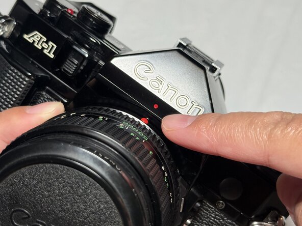

    • Press and hold the silver button located on the bottom right side of the lens.
    • While holding the button, twist the lens counterclockwise until the red dots on the body and the lens on the camera align.
    • Gently pull to remove the lens.
    • Now that the lens is removed, do not touch the inside of the camera--the mirror has an extremely delicate coating and can be easily damaged.

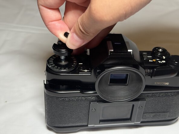

  4. Canon A-1 Light Seal Replacement: crwdns2935265:04crwdnd2935265:01crwdnd2935265:03crwdne2935265:0 Canon A-1 Light Seal Replacement: crwdns2935265:04crwdnd2935265:02crwdnd2935265:03crwdne2935265:0 Canon A-1 Light Seal Replacement: crwdns2935265:04crwdnd2935265:03crwdnd2935265:03crwdne2935265:0

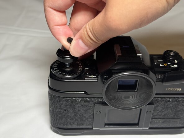

    • Lift the film rewind crank, and pull it upward until you feel a slight resistance at the first stop.
    • Continue pulling past this stop until the camera door is fully opened.

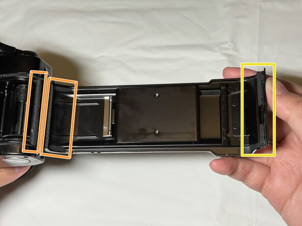

    • Identify all the areas inside the camera that require light seal replacement.
    • The following sections may need to be cleaned and re-sealed:
    • The top and bottom crevices inside the film chamber.
    • Both sides of the door hinge.
    • The door latch on the opposite side of the door.

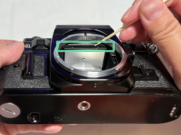

    • The mirror bumper near the lens mount.
    • Take a photo or note the foam positions before removing them in order to help with correct placement later.

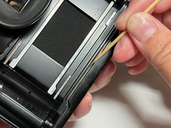

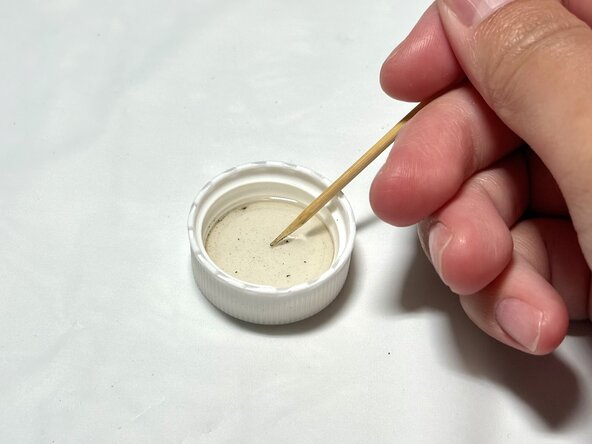

    • Use a toothpick to gently scrape off the old foam from all areas that need replacement.
    • Dip the toothpick in 91% (or greater) isopropyl alcohol (IPA).
    • Use the damp toothpick to loosen and scrape away sticky residue.
    • Repeat the same cleaning process for mirror bumper, door hinge, and any other light seal sections needing replacement.
    • Be careful not to scratch any metal surfaces or let foam particles fall inside the camera.

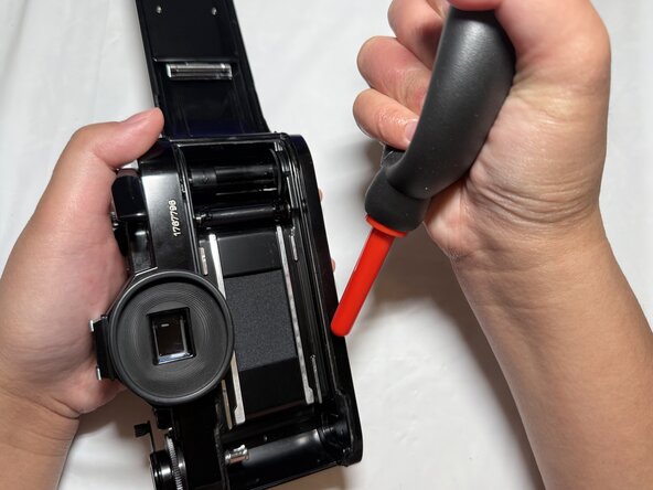

    • Squeeze the rocket blower to blow away loose foam or any foam particles that may have fallen into the camera. Hold it roughly an inch above the target areas.
    • Repeat as many times as necessary until the debris has been removed.
    • Be careful to not blow into the shutter curtain as it may cause damage.
    • Be careful not to scrape the mirror with the rocket blower as it may cause damage.

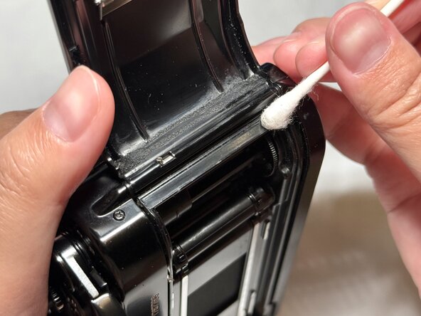

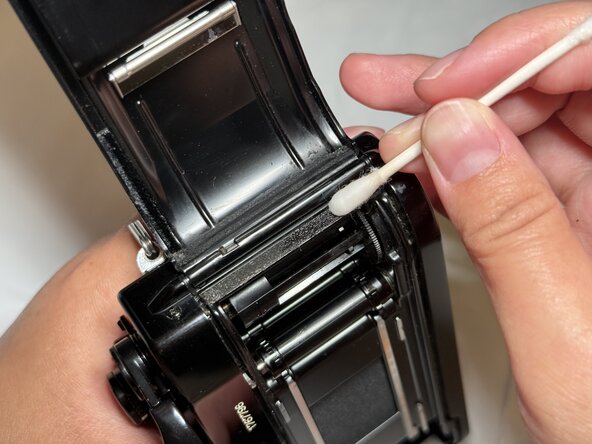

    • Dip a cotton swap into the isopropyl alcohol.
    • Ensure the Q-Tip is not soaked with isopropyl alcohol to the point of dripping.
    • With the cotton swab, wipe across the access areas, like the door hinge, while applying light pressure to remove sticky residue.
    • Repeat as many times as necessary until the camera is clean from any foam and does not feel sticky to the touch.

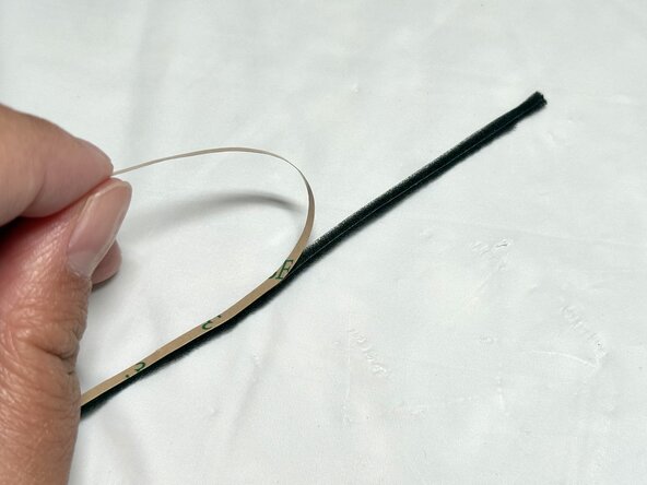

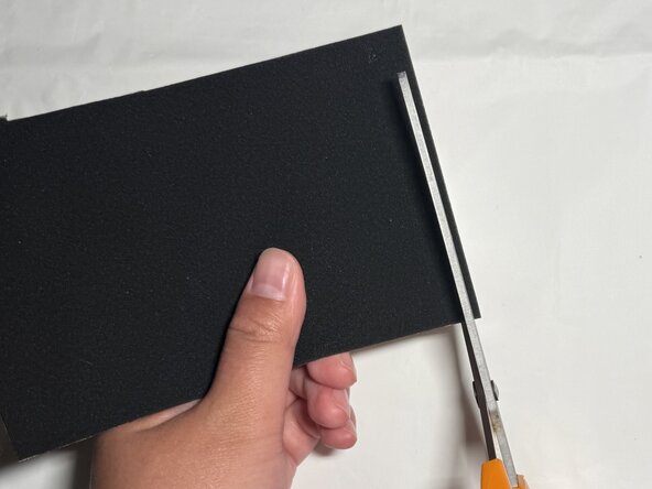

    • Measure the length of the areas where the new light seals will be placed.
    • Use scissors to cut the measured length of your new high-density foam.
    • Trim the new foam to a width of about 2-3 mm.
    • It’s okay if the foam is slightly wider than 2–3 mm, as it will compress into the grooves of the camera.

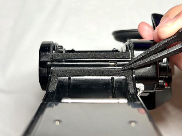

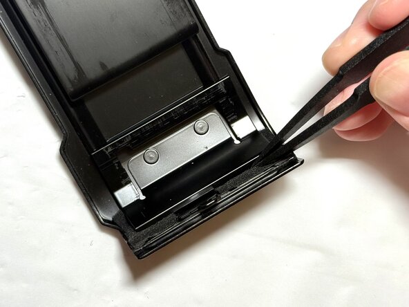

    • Use tweezers to place foam into the top groove in the camera.
    • Press it into the opening until it is flush with the sides of the space.
    • Repeat for the bottom groove, the door hinge, and other areas you are replacing.
