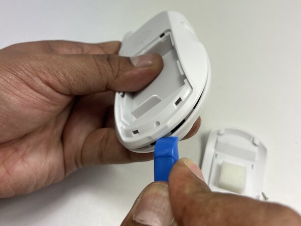

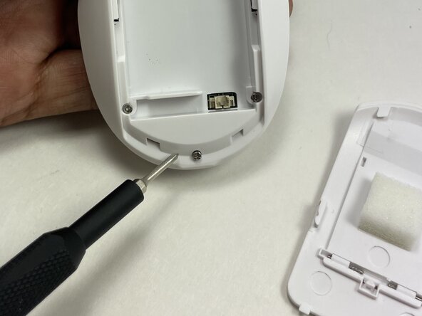

    • Use a Phillips #0 screwdriver to remove the three 12.7 mm screws from the lower back of the device.
    • Insert the tip of an iFixit opening tool between the front and back casing seams to release the clips securing the two halves.
    • Gently pry apart the handheld unit.

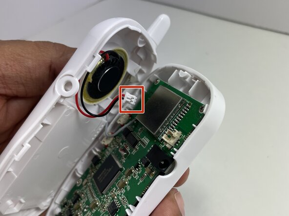

    • Unplug the speaker cable from the socket on the motherboard.

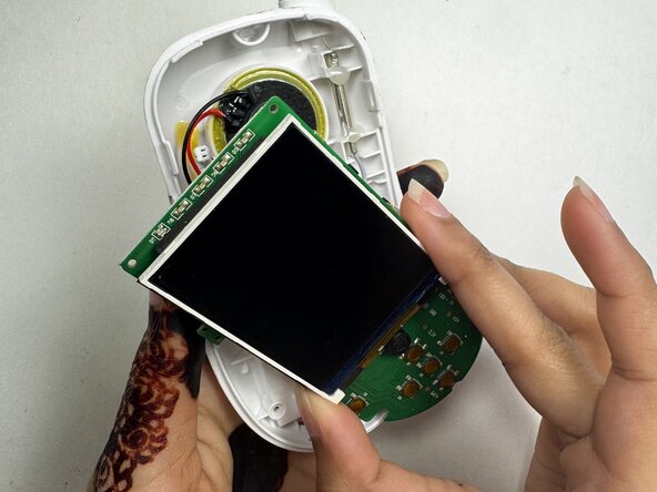

    • Using a Phillips #00 screwdriver, remove the four 6.35 mm screws from the corners of the motherboard.

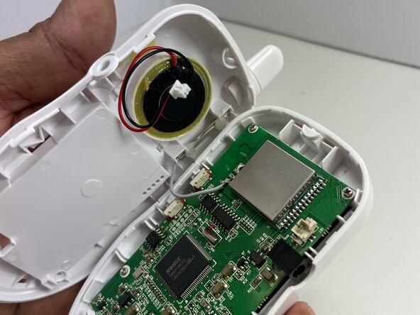

  6. CamPark BM20 Buttons Replacement: crwdns2935265:06crwdnd2935265:01crwdnd2935265:02crwdne2935265:0 CamPark BM20 Buttons Replacement: crwdns2935265:06crwdnd2935265:02crwdnd2935265:02crwdne2935265:0

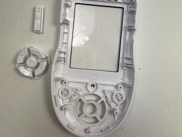

    • Remove the motherboard from the front case and set it on the bottom case with the speaker.
  7. CamPark BM20 Buttons Replacement: crwdns2935265:07crwdnd2935265:01crwdnd2935265:03crwdne2935265:0 CamPark BM20 Buttons Replacement: crwdns2935265:07crwdnd2935265:02crwdnd2935265:03crwdne2935265:0 CamPark BM20 Buttons Replacement: crwdns2935265:07crwdnd2935265:03crwdnd2935265:03crwdne2935265:0

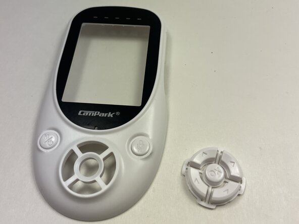

    • Remove the volume and directional buttons from the top cover.
    • The power and speaker buttons cannot be removed without breaking them off.
