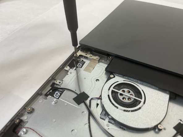

  7. CHUWI GemiBook XPro Screen Replacement: crwdns2935265:07crwdnd2935265:01crwdnd2935265:03crwdne2935265:0 CHUWI GemiBook XPro Screen Replacement: crwdns2935265:07crwdnd2935265:02crwdnd2935265:03crwdne2935265:0 CHUWI GemiBook XPro Screen Replacement: crwdns2935265:07crwdnd2935265:03crwdnd2935265:03crwdne2935265:0
    • Use a Phillips #1 screwdriver to remove the four 4.3 mm screws on the left hinge, and the three 4.3 mm screws on the right hinge.
    • Use a Phillips #1 screwdriver to remove one 5.6 mm hinge screw on the lower-right side of the right hinge.

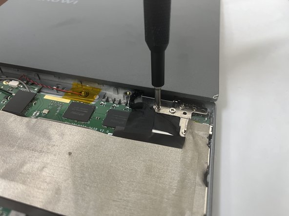

  8. CHUWI GemiBook XPro Screen Replacement: crwdns2935265:08crwdnd2935265:01crwdnd2935265:03crwdne2935265:0 CHUWI GemiBook XPro Screen Replacement: crwdns2935265:08crwdnd2935265:02crwdnd2935265:03crwdne2935265:0 CHUWI GemiBook XPro Screen Replacement: crwdns2935265:08crwdnd2935265:03crwdnd2935265:03crwdne2935265:0
    • Peel back the black tape near the right hinge.

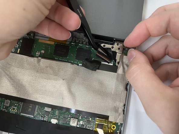

  9. CHUWI GemiBook XPro Screen Replacement: crwdns2935265:09crwdnd2935265:01crwdnd2935265:02crwdne2935265:0 CHUWI GemiBook XPro Screen Replacement: crwdns2935265:09crwdnd2935265:02crwdnd2935265:02crwdne2935265:0
    • Disconnect the display ribbon cable.
