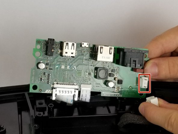

Use this guide to replace the top buttons on your device.
    1. Bose SoundTouch 20 Buttons Replacement, Buttons: crwdns2935265:01crwdnd2935265:01crwdnd2935265:02crwdne2935265:0 Bose SoundTouch 20 Buttons Replacement, Buttons: crwdns2935265:01crwdnd2935265:02crwdnd2935265:02crwdne2935265:0
      • Remove the (6) six 1.5 cm Phillips screws holding on the bottom cover of the speaker using a Phillips #0 screwdriver.
      • Lift the cover straight up and set the cover to the side.
    2. Bose SoundTouch 20 Buttons Replacement: crwdns2935265:02crwdnd2935265:01crwdnd2935265:02crwdne2935265:0 Bose SoundTouch 20 Buttons Replacement: crwdns2935265:02crwdnd2935265:02crwdnd2935265:02crwdne2935265:0
      • Gently pull the white ribbon from the connector on the top side of the motherboard.
      • Make sure to pull straight back so you don't bend or damage the ribbon.

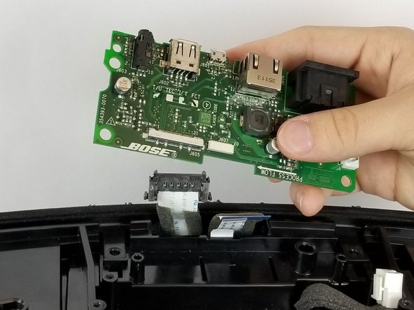

    3. Bose SoundTouch 20 Buttons Replacement: crwdns2935265:03crwdnd2935265:01crwdnd2935265:02crwdne2935265:0 Bose SoundTouch 20 Buttons Replacement: crwdns2935265:03crwdnd2935265:02crwdnd2935265:02crwdne2935265:0
      • Remove the (4) four 1.5 cm screws connecting the motherboard to the speaker.
      • Remove the (2) two 1 cm screws connecting the motherboard to the speaker.
      • When lifting the board, be careful of the two ribbons located underneath the board. Don't lift the board straight up, instead tilt it towards the cables. As shown in picture 2.
    4. Bose SoundTouch 20 Buttons Replacement: crwdns2935265:04crwdnd2935265:01crwdnd2935265:02crwdne2935265:0 Bose SoundTouch 20 Buttons Replacement: crwdns2935265:04crwdnd2935265:02crwdnd2935265:02crwdne2935265:0
      • Remove the white cable by pressing on the side of the connector with a tab and pulling backwards.
    5. Bose SoundTouch 20 Buttons Replacement: crwdns2935265:05crwdnd2935265:01crwdnd2935265:02crwdne2935265:0 Bose SoundTouch 20 Buttons Replacement: crwdns2935265:05crwdnd2935265:02crwdnd2935265:02crwdne2935265:0
      • Gently pull the thinner white ribbon located towards the center of the board.
      • Pull straight down to prevent bending or damaging the ribbon.
      • Squeeze the plastic sides of the plug and pull straight down to remove this ribbon.
      • After removing the two ribbons, completely remove the motherboard and set it to the side.
    6. Bose SoundTouch 20 Buttons Replacement: crwdns2935265:06crwdnd2935265:01crwdnd2935265:02crwdne2935265:0 Bose SoundTouch 20 Buttons Replacement: crwdns2935265:06crwdnd2935265:02crwdnd2935265:02crwdne2935265:0

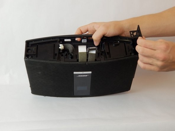

      • To remove the side panel from the speaker, lift the top of the sides from the slots.
      • The sides will be bent up after removing from the slots, they do not come up right away.
      • After completing the previous step, pull gently straight up to remove the side.
      • Repeat on both sides of the speaker.
    7. Bose SoundTouch 20 Buttons Replacement: crwdns2935265:07crwdnd2935265:01crwdnd2935265:03crwdne2935265:0 Bose SoundTouch 20 Buttons Replacement: crwdns2935265:07crwdnd2935265:02crwdnd2935265:03crwdne2935265:0 Bose SoundTouch 20 Buttons Replacement: crwdns2935265:07crwdnd2935265:03crwdnd2935265:03crwdne2935265:0

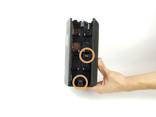

      • Remove the (2) two 1.5 cm screws circled in picture one.
      • Rotate the speaker to its side and remove the (2) two 1.5 cm screws circled in picture 2. Remove these screws on either side of the speaker.
      • After all screws are removed, gently remove the cover from the speaker as shown in picture 3.

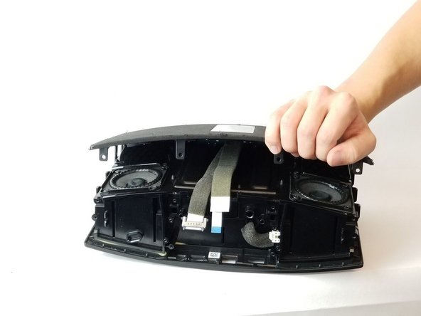

    8. Bose SoundTouch 20 Buttons Replacement: crwdns2935265:08crwdnd2935265:01crwdnd2935265:03crwdne2935265:0 Bose SoundTouch 20 Buttons Replacement: crwdns2935265:08crwdnd2935265:02crwdnd2935265:03crwdne2935265:0 Bose SoundTouch 20 Buttons Replacement: crwdns2935265:08crwdnd2935265:03crwdnd2935265:03crwdne2935265:0
      • After lifting the cover, you will see two ribbons attaching the cover to the speaker. Gently remove these ribbons by pulling straight down.
      • Make sure to pull the ribbons straight out so you don't bend or damage the ribbon.
    9. Bose SoundTouch 20 Buttons Replacement: crwdns2935265:09crwdnd2935265:01crwdnd2935265:02crwdne2935265:0 Bose SoundTouch 20 Buttons Replacement: crwdns2935265:09crwdnd2935265:02crwdnd2935265:02crwdne2935265:0

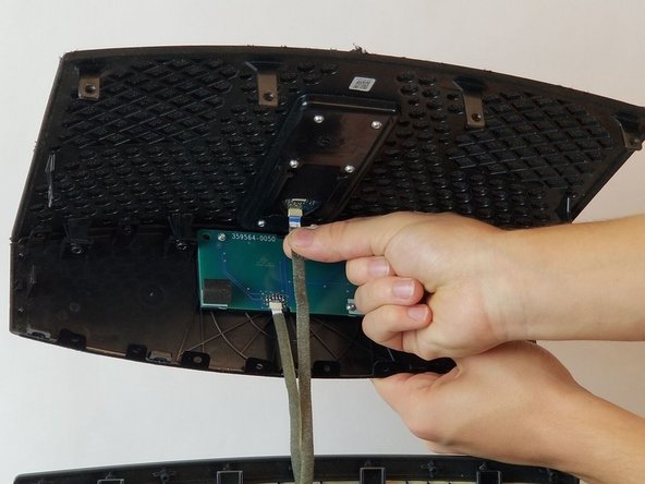

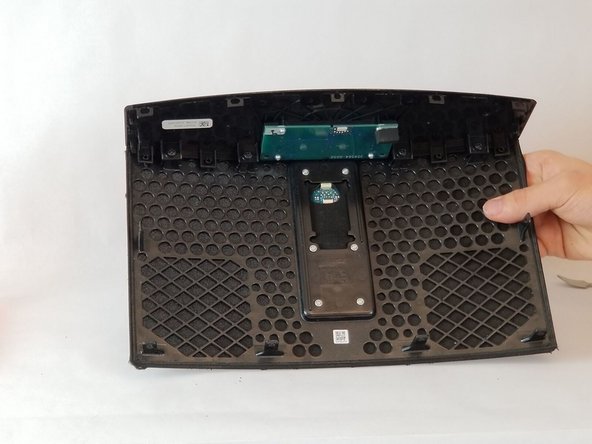

      • Place the fully separated cover face down on a surface.
      • Using a star bit screwdriver, remove the three screws circled in picture 1.
      • Unplug the plug boxed in on picture 1.
      • Gently push out the button board from the top of the cover.

I accidentally broke the ribbon cable while cleaning the front mesh panel. Can you please suggest exact specification for Ribbon cable attached to the cover of the speaker. For your reference please see image in step 8 of Bose SoundTouch 20 Buttons Replacement
