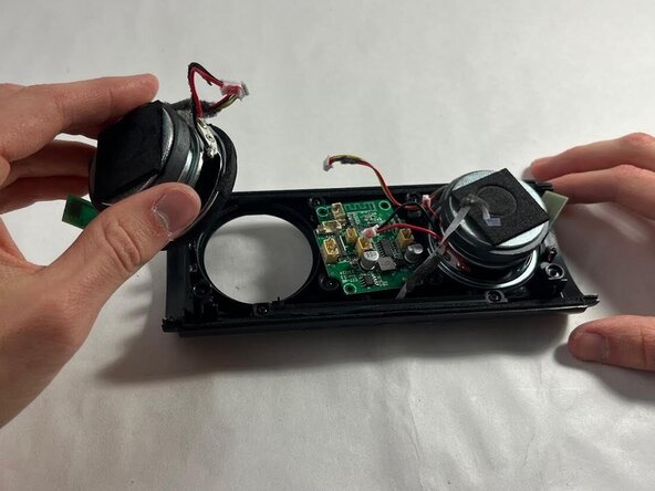

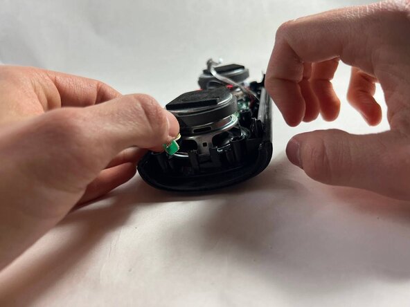

    • Unplug the driver connectors from the motherboard.
    • Remove the driver.
    • If you have difficulty with the wires, wiggle the connector back and forth to loosen it.
  10. BolaButty X-GO C27-C Motherboard Replacement: crwdns2935265:010crwdnd2935265:01crwdnd2935265:01crwdne2935265:0
    • Repeat previous two steps for the second speaker.

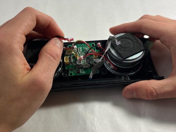

  11. BolaButty X-GO C27-C Motherboard Replacement, Motherboard: crwdns2935265:011crwdnd2935265:01crwdnd2935265:02crwdne2935265:0 BolaButty X-GO C27-C Motherboard Replacement, Motherboard: crwdns2935265:011crwdnd2935265:02crwdnd2935265:02crwdne2935265:0
    • Use tweezers to disconnect the two cables connected from the daughterboard.
    • Make sure to pull on the plastic connector and not on the wires to avoid damaging the wires.

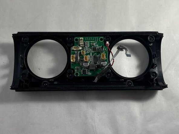

  12. BolaButty X-GO C27-C Motherboard Replacement: crwdns2935265:012crwdnd2935265:01crwdnd2935265:01crwdne2935265:0
    • Use the Phillips #0 screwdriver to remove the four 8 mm screws holding the motherboard in place.
  13. BolaButty X-GO C27-C Motherboard Replacement: crwdns2935265:013crwdnd2935265:01crwdnd2935265:01crwdne2935265:0
    • Lift the motherboard out.
